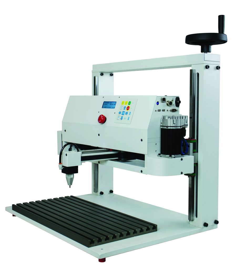

The cantilevered marking head provides a clear open line of sight while the marking head can retract “back” to clear other tooling and equipment. Up to six axes are motion control ready and no PC or control box is required. For custom integration with logic, additional I/O is available.
This dot peen marker — manufactured in the U.S. — features machine-tool quality construction with twin rigid upright column leadscrew and ball slide design, brushless servomotors and non-contact limit home sensors and a large t-slot table for fixturing. The X-12 Model has a 12″x6″ marking area; the X-24 Model has a 24″x6″ marking area, both have a 12″ height capacity. They are also available with programmable Z axis (full column height).
A true file based solution with our patented iTeach function allows you to use the marking tip as a “pointer” to define the text path. The latest embedded controls feature CF card memory with preprogrammed functions, job selection or data input and bar code input ready.
