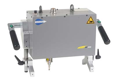

The XF530m from Technifor Inc. has a large marking field measuring 200 x 50mm, and is equally efficient at marking texts, logos, dates and variables. Marking can be flat, angled or radiating, and various font types are available. The XF530m is particularly ergonomic in design. Marking trigger buttons are positioned on the machine's grab handles so that it can easily be held in position during the marking process.
Its detached control unit is designed to be used anywhere in the world. To date, the interface can operate in more than 20 languages. The integrated control software is intuitive and user-friendly, making it very quick to set up a new marking template. There is also a large backlit screen to provide a quick view of the resultant marking.
Fitted with the latest generation of communication tools, the XF530m has a wide range of connection interfaces (RS232, Ethernet and 8-in/4-out) so that links can be established with the computer network, assembly line PLC, etc. A simple USB memory stick can be used to import and export templates and logos. It has sufficient memory capacity to store more than 1,000 marking templates.
