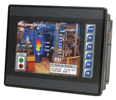

The EXL6 OCS controller is an evolution of the historically popular XL6e controller; known for its comparable size, color touchscreen and versatility. Building from the XL6e’s proven foundation, the EXL6 makes several enhancements to the overall design of this mid-range OCS controller offered by Horner such as:
• Improved resolution on the 5.7″ VGA color touchscreen at 640 x 480 pixels,
• Faster logic execution with a scan rate of 0.013 mS/K (about twice the speed as the XL6e)
• The addition of an active serial port resulting in three ports total
Utilizing the current Cscape 9.6, Service Pack 4 and the latest revision of Firmware 14.12 (also released today), the resolution and graphics on the EXL6 are more comprehensive and enhanced than on previous models. Along with better resolution and faster logic execution, the EXL6 also sees improvements in the overall screen response time, making screen transitions and overall application functions more streamlined and efficient.
