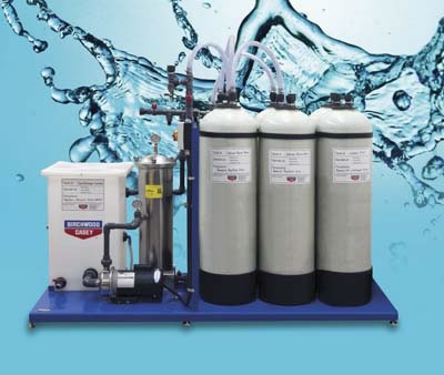

Birchwood Casey’s LUMICLAD electroless black oxide process for aluminum is now available in a new Zero-Discharge configuration that eliminates the need for a drain connection. The LUMICLAD system utilizes Ion Exchange technology to purify and recycle the rinse waters, resulting in a “closed-loop” zero-discharge installation.
The technology is available for all size systems, including 40-gallon, 100-gallon and larger capacity custom tank systems. The LUMICLAD process, from Birchwood Casey, is the innovative alternative to black anodizing for aluminum components. This 30-minute process produces a durable, satin black finish that is 60 millionths thick (1.5µm), with a smooth, clean surface that is electrically conductive and tightly adherent to the aluminum substrate.
“Ion Exchange equipped LUMICLAD systems work well in those installations where it is impossible, or impractical, to send process rinse waters to the drain,” reports Mark Ruhland, vice president of Birchwood Casey. “In facilities with septic systems, or in plant locations inconvenient to city drain connections, the Ion Exchange system allows the process line to operate as a self-contained system. By recycling the rinse waters, the need for a drain connection and discharge permit is eliminated.”
The Ion Exchange system removes all particulates and dissolved ions from the rinse waters, generating de-ionized water that is re-used over and over. The user gets ultra clean rinse tanks, no discharge to the drain, and near zero water consumption. The LUMICLAD process is a simple in-house alternative to the complex and costly black anodizing process. Utilizing a simple immersion tank procedure, with no electrolytic racking, the LUMICLAD system is safe to install in any area of the plant. The new Ion Exchange feature allows the process to be installed anywhere, without a sewer connection. The LUMICLAD system serves as a great alternative to black anodizing.
