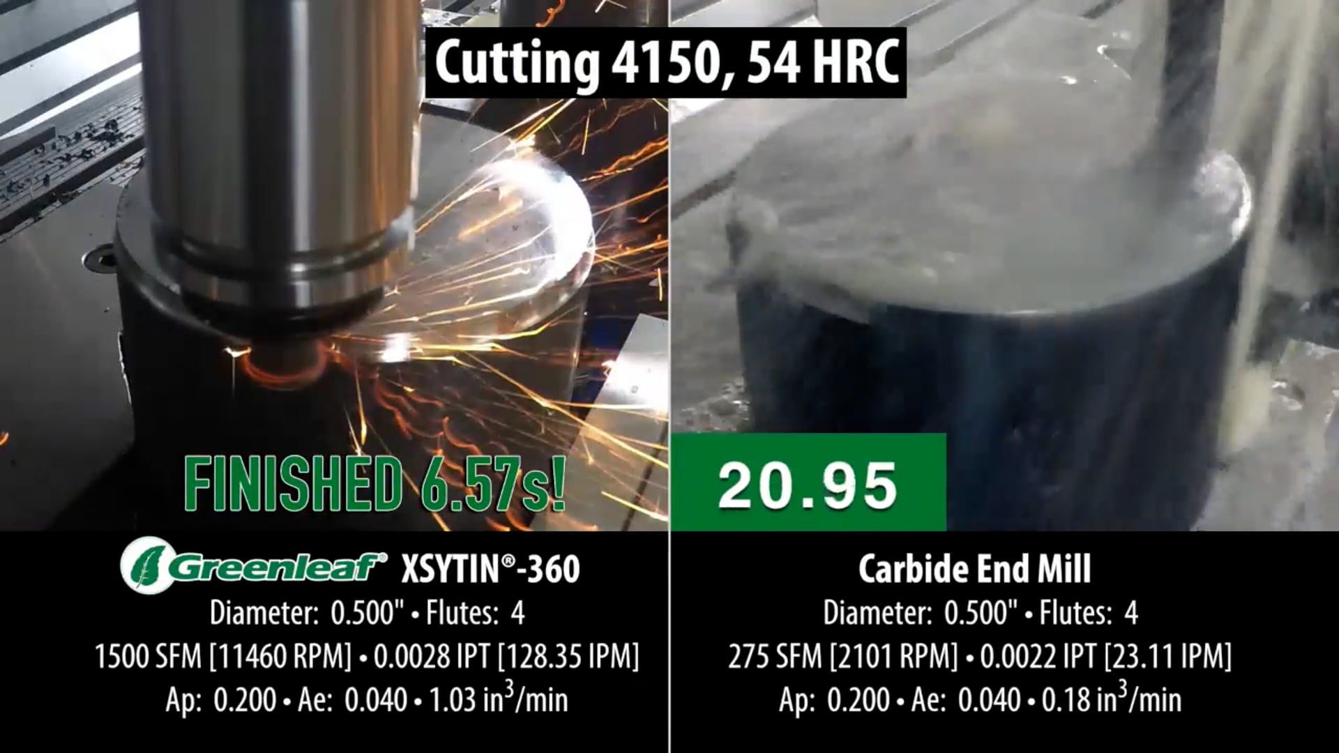

Greenleaf’s XSYTIN®-360 ceramic end mills combine Greenleaf’s phase-toughened XSYTIN®-1 substrate with a unique cutting geometry that offers ten times higher productivity and tremendous cost savings. The strength of the material allows users to apply chip loads similar to solid carbide end mills with higher speeds common to ceramic machining.
