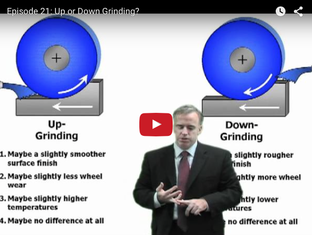

Grinding: Up or down?
Published Date
July 05, 2011 - 07:30:pm
For the 21st episode of Cutting Tool Engineering magazine's Grinding Doc Video Series, a shop wondered whether it's better to up-grind or down-grind? Dr. Jeffrey Badger, the host of the video series, responds.
