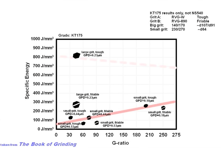

A machine shop turned to Dr. Jefffrey Badger—the Grinding Doc—seeking relief from the painfully long cycle times endured grinding cermets. The Grinding Doc explains what the shop should do to stop the pain.
