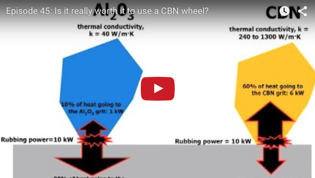

A shop is grinding hardened steel, and periodically switches between a CBN wheel and an aluminum-oxide wheel. Given that the shop is getting pretty much the same material removal rate, surface finish and cycle times with both wheels, the shop is beginning to wonder if it's really worth it to use a CBN wheel. Dr. Jeffrey Badger, the host of Cutting Tool Engineering's Grinding Doc Video Series, responds in the 45th episode of the video series.
October 5, 2013
