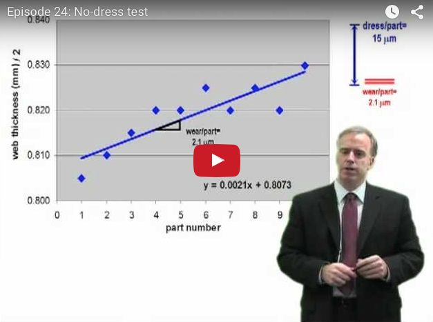

Dr. Jeffrey Badger, the host of Cutting Tool Engineering magazine's Grinding Doc Video Series, responds to a shop that performs high-production grinding of small parts and experiences trouble when determining how much to dress a wheel. Watch the 24th episode now.
