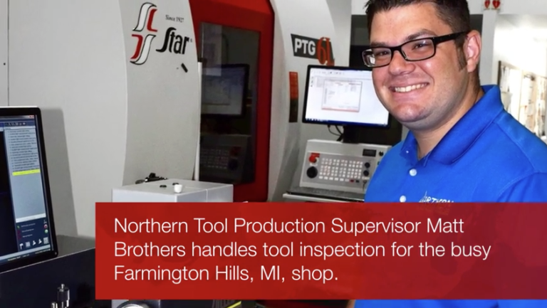

Matt Brothers, Production Supervisor, Northern Tool is tasked with tool inspection for the busy shop. He started in the industry in 2001 after schooling in electrical engineering. “Because I showed interest in tool inspection, I was put in the inspection department,” Matt said. “Tool inspection is what I do.”
“I am always looking for the latest and greatest thing out there to help the shop use the best technology available,” Matt said. “In 2006 I was introduced to Zoller through its »genius 3« tool inspection system. I was trained on that and saw how easy the Zoller tool inspection software is to use and have been convinced ever since.”
