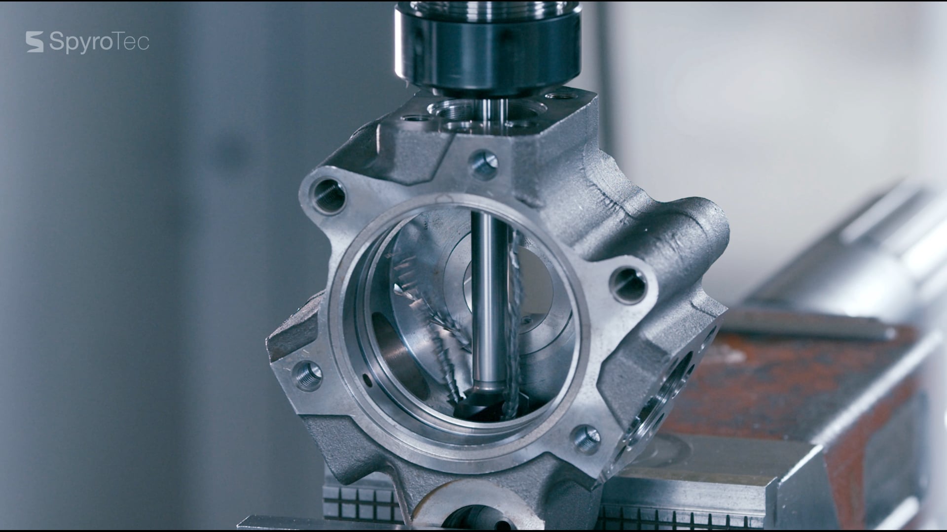

This innovative, helical HSS and HSCO countersink drastically reduces axial and radial forces that occur during countersinking, due to the unique geometry of the cutting edge design. SpyroTec's convex form and variable pitch cutting edges provide a stable countersinking process and minimal vibration – even when using a hand drill. Available from stock in 90 degree, 82 degree and 60 degree countersinks – also in convenient sets!
