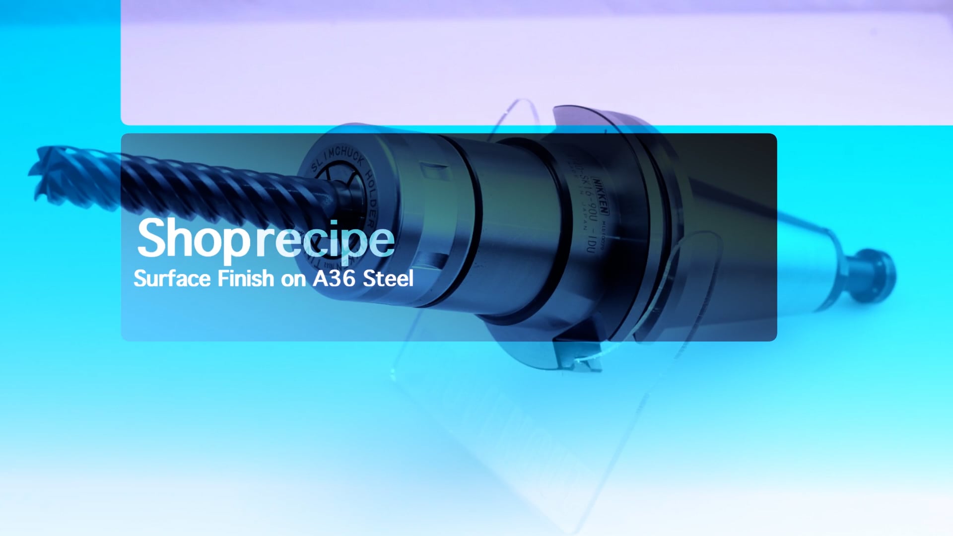

ProvenCut recipe 586 struck a wonderful balance, machining a piece free of chatter and yielding an extraordinary finish using a YG-1 V7 PlusA six-flute endmill held in a Lyndex-Nikken SK16 collet holder. The 2D contour finishing operation was programmed with Autodesk Fusion 360 and run at 210 m/min. (690 sfm) at 0.015 mm feed per tooth (0.0006" feed per tooth) with a 0.203 mm (0.008") radial DOC and 63.5 mm axial DOC.
