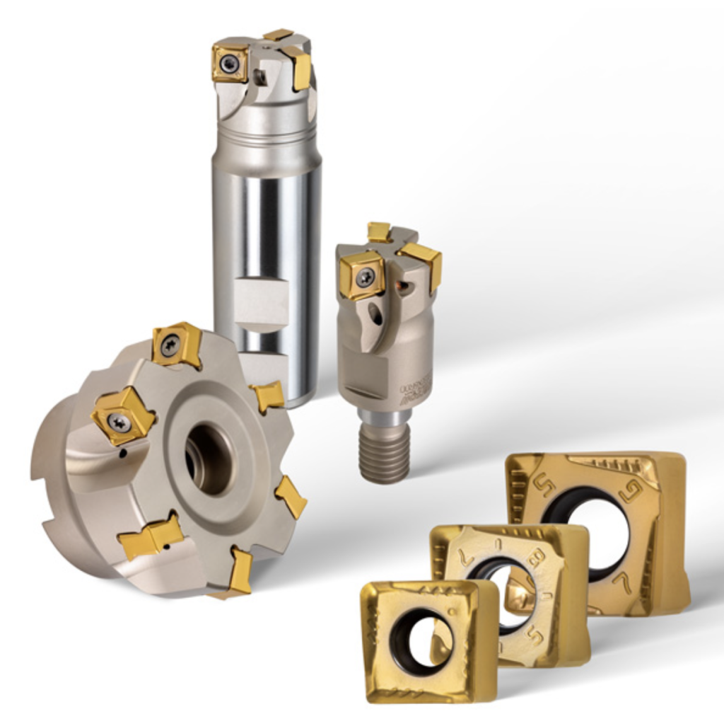

High axial rake reduces cutting loads and promotes smooth machining.
07 mm & new 10 mm inserts generate true 90° and are optimized to step down axially with minimal mismatch.
12 mm Insert generates true 90° up to .33 depth of cut.
Unequally spaced insert placement aids to diffuse vibration.
Integrated wiper flats produce 32-63 Ra finishes.
Medium and fine-pitch cutters compliment the geometry for premium performance.
