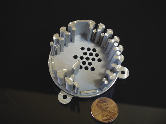

Courtesy of Xact Wire EDM
Xact Wire EDM produces an array of surgical instruments. The large block shows a good example of chaining and stacking.

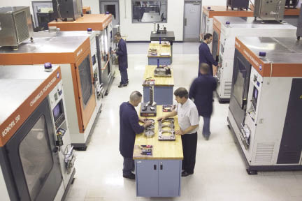

Courtesy of Methods Machine Tools
Methods Machine Tools designed and built this production EDMing cell, which uses a Fanuc robot on a rail to load a Fanuc wire EDM, an exeron sinker EDM and a Fanuc TrodeMaster graphite mill. The rack in the front left corner is for handling electrodes made on the mill for use in the sinker EDM. The rack in the back holds workpieces.
