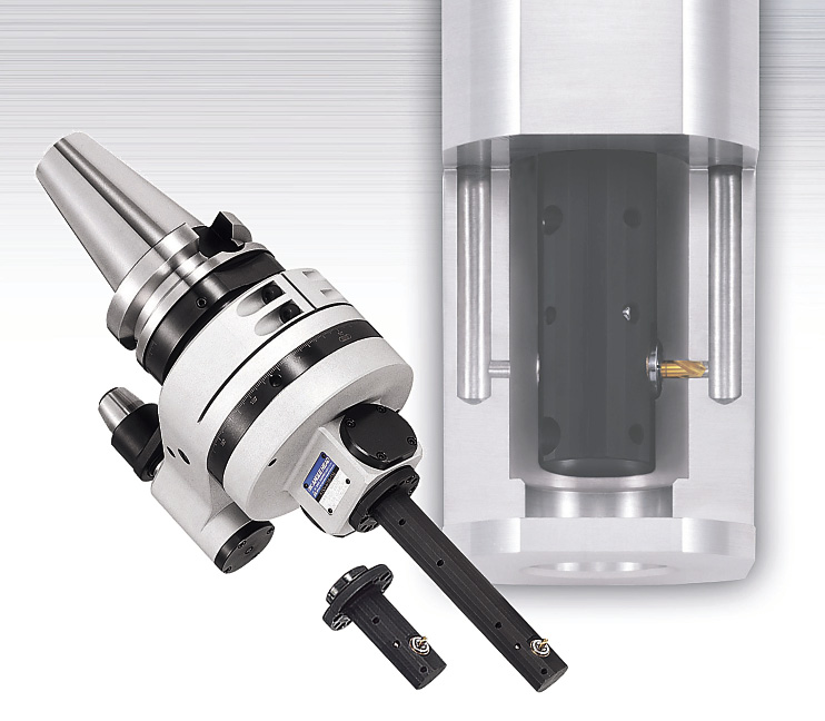

An offset angle head from Koma Precision is used
to cut a keyway in a part ID. Image courtesy Koma Precision.

The output of this AGU90 geared angle head from BIG Kaiser can be adjusted in 1° increments, while the entire base is adjustable 360° to provide any compound angle. Image courtesy BIG Kaiser Precision Tooling.

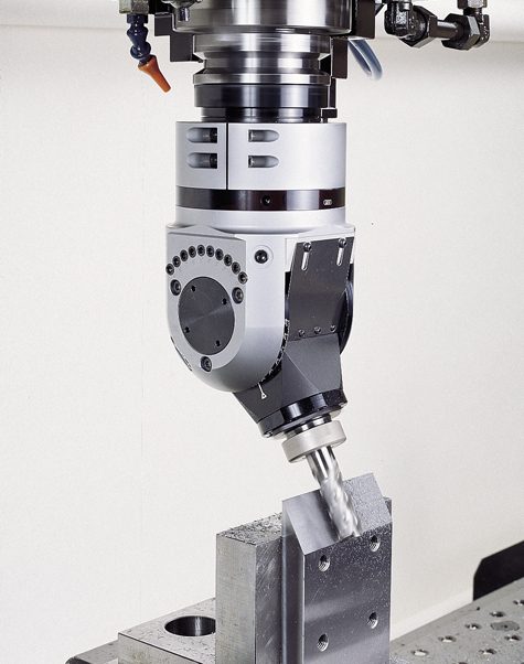

OMG offers a special adjustable angle head with a BT50 shank, an ABS25 output spindle
and a spindle speeder with a 6:1 ratio. The maximum output speed is 15,000 rpm.

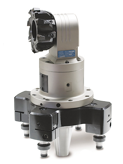

Facemilling is one application for which angle heads are suitable. Image courtesy Koma Precision.

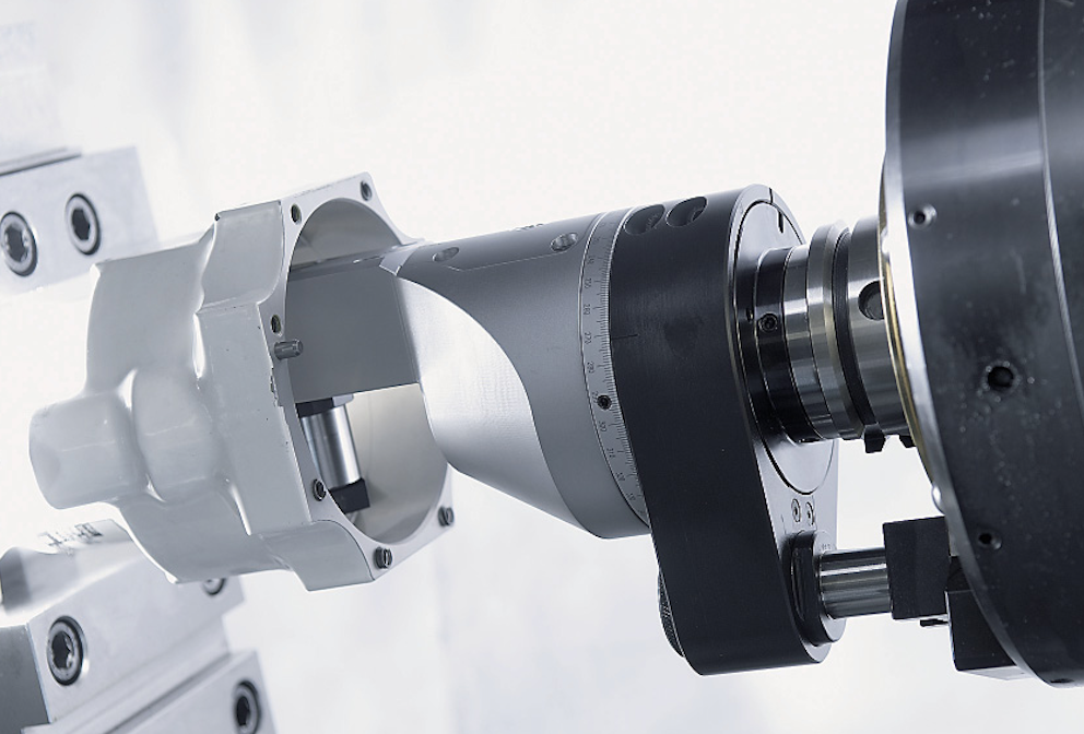

When a parts manufacturer purchases a right-angle head, it’s usually not for a dedicated production operation. To allow a standard ER-output live tool to accept various adapters for different applications, Heimatec Inc. offers the U-tec flexible adapter system on its right-angle heads. This lets users quickly changeover tools on almost any lathe or mill, using a single live tool, without having to commit to a quick-change system on the initial purchase.
How Angle Heads Streamline Multi-Axis Machining Operations
Heimatec offers the U-tec flexible adapter system for all major
turning machines on the market. Image courtesy Heimatec.
“Customers often want to do different things when they invest in an expensive tool like that,” said Heimatec’s Preben Hansen, “so we have a changing system built into it.”
This enables a user to take the ER collet out and put in, for example, a side-lock holder, an extension or a facemill, shell mill or endmill adapter, without the need to install a completely new base. “You can even do a drilling and tapping application with the same tool,” Hansen added. “You stop the program and change the insert instead of buying two angle heads.”
He noted the adapter system is especially beneficial to users doing deep-hole drilling with extended tools because of its rigidity and quick-change capabilities.
