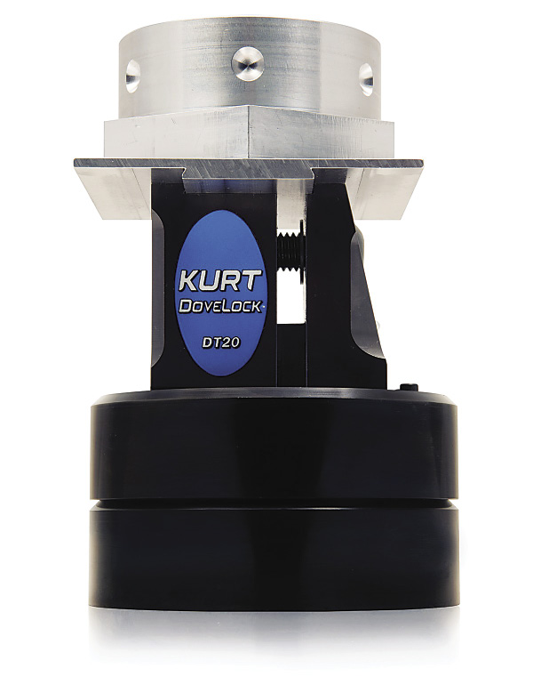

Kurt’s DT20 single-acting vise grips the bottom of an aluminum workpiece.
A secondary operation is needed to remove the sacrificial material and
machine the backside of the part. Image courtesy Kurt Industrial Products.

Kurt also offers the DT20, a push-type, 5-axis vise constructed of hardened 4140 steel, with a dovetail clamping surface and fixed positioning pin. (See photo above.) Dovetail vises require the workpiece to be prepped in advance by cutting a pair of opposing dovetail grooves on either side of the workpiece. (See sidebar at the end of this article.) This gripping area must then be machined away during a subsequent operation, or the workpiece is sliced away from the sacrificial material after completion. Despite the need for premachining, Kane noted many of his customers prefer a dovetail design. “For those shops taking heavy cuts, dovetails are the clear choice,” he said. “The part absolutely cannot lift up.”

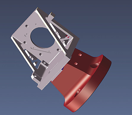

Another proponent of dovetail-style vises is Raptor Workholding Products Inc., Burbank, Calif. The company introduced its single-acting modular vises in 2008, when David Fisher, president of parent company S&H Machine Inc., started using Raptor in his Burbank aerospace machine shop. Fisher and his team recently expanded the Raptor line with a self-centering model. “We found there’s definitely a need for this type of vise,” he said. “The MSV1000 can be used with traditional dovetail jaws or machined to grip directly on the finished workpiece for secondary operations.”

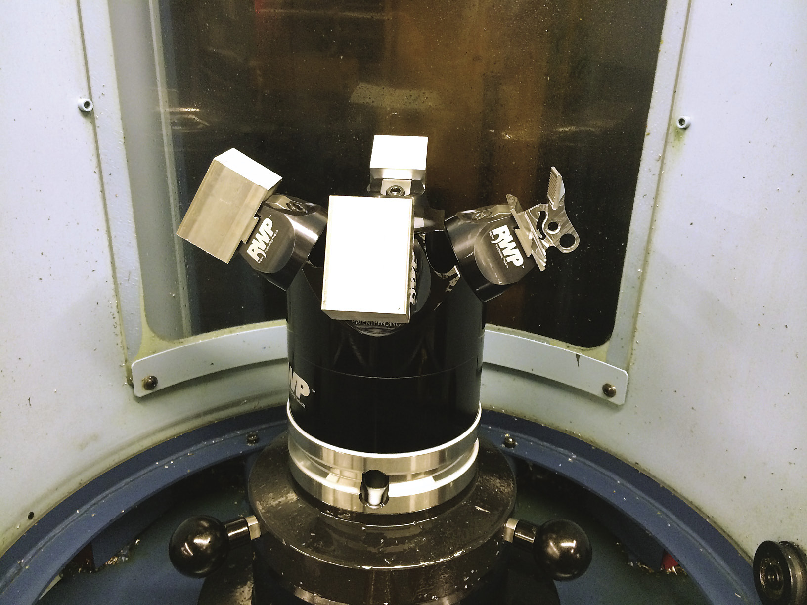

Fisher said one shortcoming of many 5-axis workholding systems is the inability to load more than one part at a time into the machine. This limits a shop’s ability to run unattended, as an operator must be available—or a robot if the shop is so equipped—to load a fresh blank into the vise more frequently than with horizontal or 3-axis vertical machining centers, where multiple part fixturing is the norm. Raptor avoids this limitation with its multiple-fixture systems, which can hold two, four or six parts at once, but still provide adequate clearance for tools to reach the sides of each workpiece.

“Success with clamping multiple parts in a 5-axis machine depends on the workpiece geometry,” Fisher said. “With larger parts or where small features require the spindle to approach close to the workpiece, interference can be a problem. We have one job where we had to limit the setup to three parts per cycle, but this still gives us nearly 6 hours of unattended machining.”
Darin Wion, vice president of sales and marketing for Raptor, said workholding is often overlooked when a shop purchases its first 5-axis machining center. “Quite often the workholding comes last in the pecking order,” he said. “They’ve thought through the toolholders, the cutting tools, but then once the machine is sitting on the floor, they are left scratching their heads over how to hold the parts. A lot of times they end up throwing a single-station vise on a machine that’s capable of running multiple parts at one time. It undermines the entire capacity of a very expensive machine tool.”
