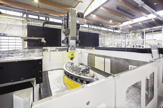

multi_functional_machining_of_ropeway_equipment_on_Droop_Rein_high_speed_machining_center.tif
Courtesy of Starrag
The Droop+Rein high-speed, multifunction machining center from Starrag has an additional turning table and performs 5-axis machining with a fork-type head.

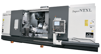

NTXL%20right%20open.tif
Courtesy of Methods Machine Tools
The Nakamura-Tome Super NTXL multitask machine handles parts up to 6.56′ long and 15.5 ” in diameter.

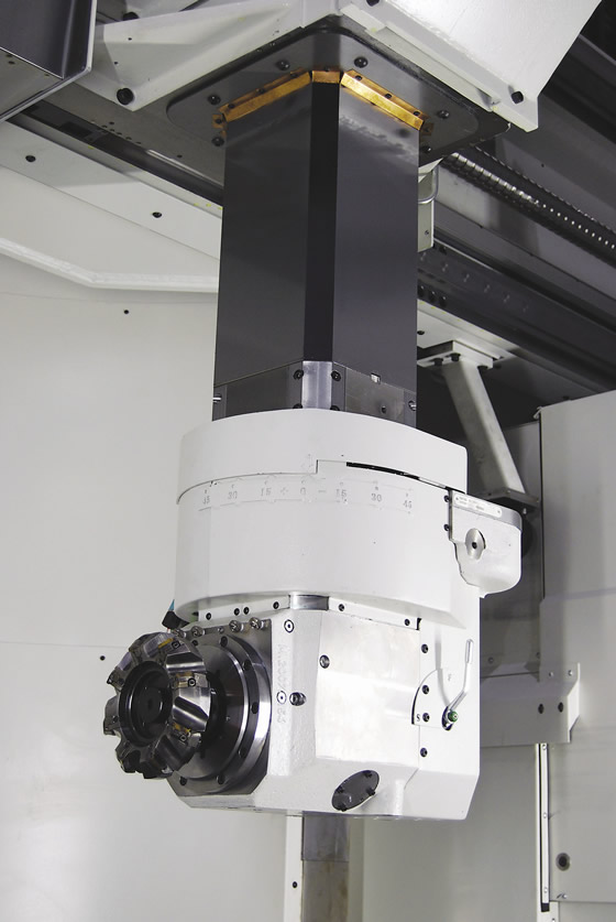

GiddingsLewisYAxis_Attachment_19.tif
Courtesy of Fives Giddings & Lewis
Fives Giddings & Lewis’ Y-axis attachment brings off-centerline turning, milling, drilling and tapping capabilities to its vertical turning centers.

Giddings & Lewis, for example, enables off-centerline turning, milling, drilling and tapping on its vertical turning centers with a Y-axis attachment that combines a C-axis head with a table and X- and Z-axis motions. “This is an affordable way to reduce setups and free up machine time on the horizontal machining centers and boring mills that used to be required to produce these same features on turned parts,” Beyer said.

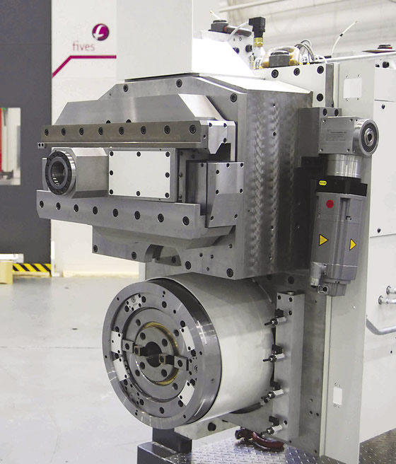

In addition, the machine tool builder offers an extended-range contouring head for its horizontal boring mills to produce large, turned features with a repeatability of ±0.005mm (±0.0002 “) and an accuracy of ±0.015mm (±0.0006 “).

IntegratedContourHead.tif
The integrated contouring head from Fives Giddings & Lewis enables a boring mill to turn large part features, particularly ones for the energy industry.
