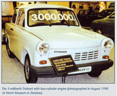

From 1988 onwards, the assembly line, delivered by VW, was meant to only built water-cooled four-cylinder, four-stroke engines into GDR cars. A newly built plant in Chemnitz should build the engines, previously propelling the VW Golf, with 40 or 55 hp (1,100 or 1,300 cm3 capacity); the same applied for a diesel version.
About 190,000 engines were meant to be built for domestic demand, another 100,000 for VW. Finally, in October 1988 – after the end of the autumn trade show in Leipzig – the beginning of a new era for the GDR automobile industry could take its course, as planned in 1984.

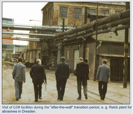

Together with Gerd Gottschalk, I visited many facilities within the GDR – many with illustrious names such as Heckert-Werke and Research Centre in Chemnitz, Robotron, a manufacturer of electronics and accounting machines, Wismut, VEB combinate “Getriebe und Kupplungen” (gears and clutches) in Magdeburg, tool manufacturer Geringswalde and abrasive producer Reick in Dresden, as well as the diamond grinding shop in Quedlinburg and many others.
After receiving requests for the finally available poly tools from various industries – by the way together with inquiries about diamond dressing rolls and grinding wheels, I decided that Lach Diamant had to establish itself as service provider and consultant in an “idle” landscape. Especially after I noticed that only two grinding machines for regrinding/sharpening of PCD tools were available for the entire GDR: An old, SWU grinding machine, modified for SKM (composite), in Jena and a second machine in the research facility of Heckert-Werke in Chemnitz. Dr. Ing. Stefan Becker, who joined us in 1990 as representative for East Germany, affirmed this approach. Within only a few months, five new sales representatives delivered knowhow and service to the “capable” companies in the East.
Unfortunately, these capable companies became less and less. Either the sudden performance pressure was too high or the necessary capital and equipment was not available or the necessary knowhow – in other words, work power – was no longer sufficiently available, due to the now actively starting migration towards the West.

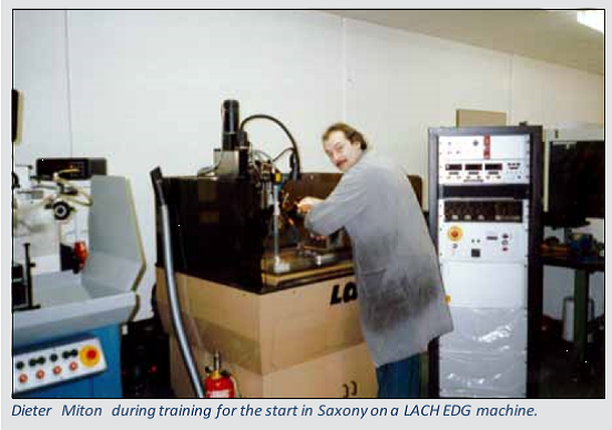

Well – we did get together after all – and he brought two new employees with him: Jörg Hänel and Dieter Miton. We had established an “autonomous” grinding service for these three in Hanau. They were trained for the establishment of a grinding and sharpening service as envisioned in the project and were prepared for opening a new production site in Saxony.

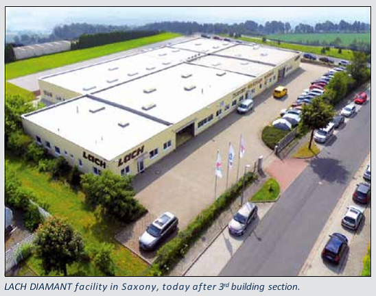

Almost at the drop of a hat, mayor Eberhard Meyner from Lichtenau, contacted us. He was very persistent and “worked” the Lach Diamant management until they finally “gave in” and purchased a nice piece of land in his newly developed industrial area for a new plant for Lach Diamant Saxony. The move into the first hall was scheduled for Juli 1997 – two subsequent building sections were planned. Thus, a German-German success story revealed 30 years after the reunification that “it was about time that the wall came down!”
Over the last 30 years, the Lach Diamant plant in Saxony contributed to our image as pioneers and innovators in our implementation of ideas for the global automobile, wind and aircraft industries – only to name a few examples.
