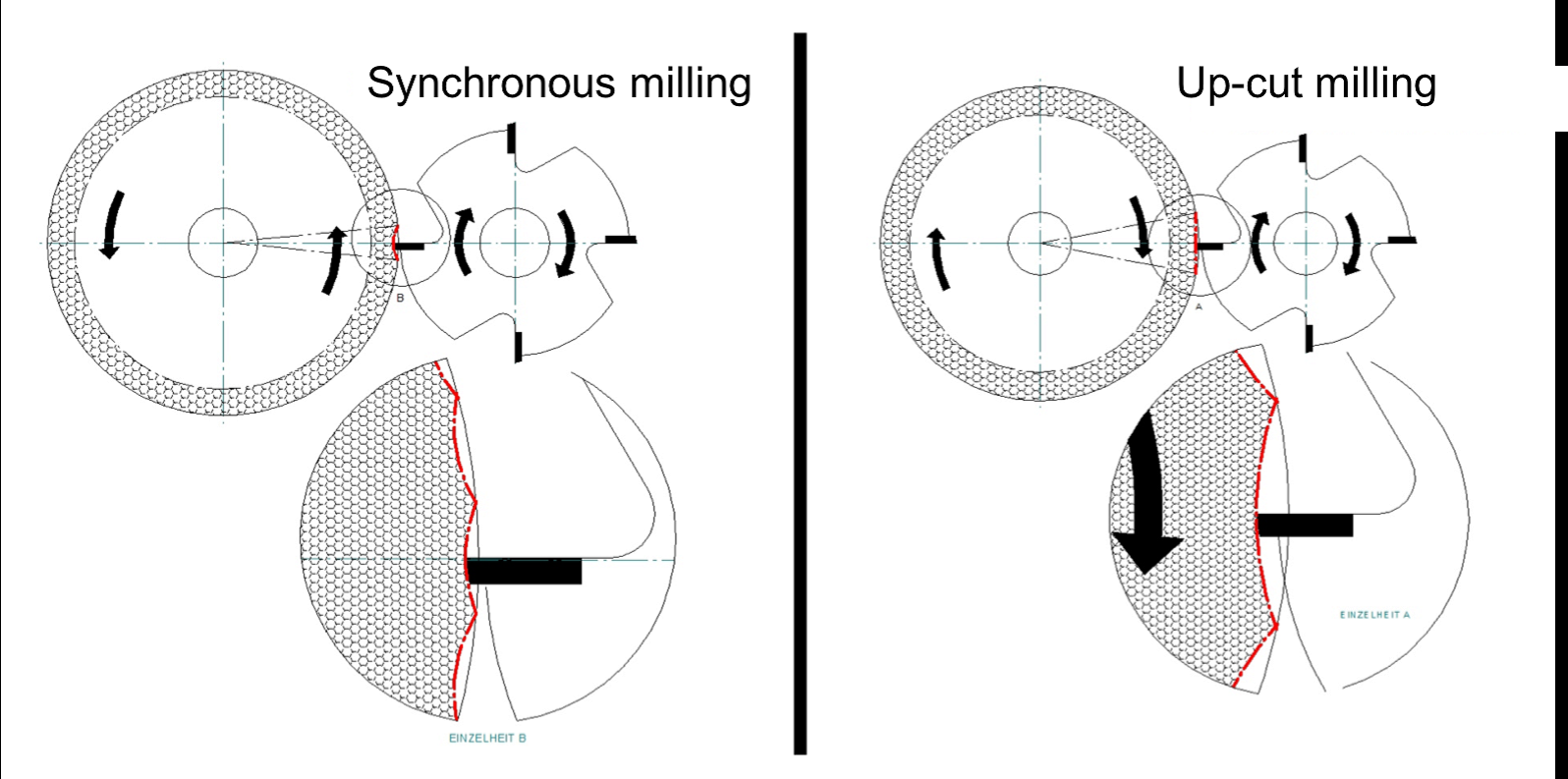

“Chip spaces” between individual teeth – or the distance from tooth to tooth – cause an unwelcome and unacceptable “comma” during plunging when milling or otherwise machining a grinding wheel. This is independent of the milling direction (see illustration below).
Chip spaces between individual teeth cause an unwelcome and unacceptable
