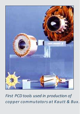

commutator manufacturer and the name “Kautt & Bux.” I called them and found out something surprising: Commutators are not turned, but ground in a very time-consuming procedure. At least that was the case in 1973.
I spontaneously explained that they could save several minutes of grinding time if they would instead replace this procedure with turning with the new PCD turning steel; they were impressed and promised to visit our stand at the Hanover Trade Show. At this point, my suggestions were only of a theoretical nature, since we did not have the

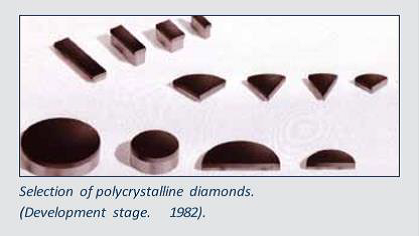

Finally, the long-awaited PCD material arrived as 90° and 60° segments, which had apparently been cut out from a 3.2 mm blank. The visible PCD diamond layer was about 0.3 – 0.4 mm thick and connected via a carbide support so that the cutting edge could be further manipulated by soldering. It was now Friday – exactly 3 business days before the start of the Hanover Trade Show on April 26, 1973. I proudly presented the first PCD to Kurt Wagner, manager of our grinding shop and a highly talented diamond grinder who had mastered his art as a diamond specialist at a Swiss manufacturer for diamond tools.
After careful inspection and several grinding attempts on a cast grinding wheel that was apparently used for natural diamonds and coated with diamond dust, he announced: “Sir, usually we do everything, but this stuff is so beastly – there is nothing we can do!” I thought, that this was probably the end of it.
There were few other grinding options. But then I thought of our Simon steel grinding machine (L15). We had purchased it for our cooperation with Simon, Neu-Isenburg, a distributor of resin- and metal-bond diamond wheels. I suggested: “Try it with the Simon machine, with the cup wheel.” And to our great astonishment, the very first
grinding attempt with a resin bond diamond grinding wheel proved already to be very promising. However, we still had to spend several hours to get the desired cutting geometry.

By the way, the technicians of Kautt & Bux were there as well and excited about the demonstrations. A first key customer for serial use of dreborid PCD tools was found – so Kautt & Bux can boast to be the first company worldwide using PCD in production. This was a stroke of luck for LACH DIAMANT because in the process of turning the surface of copper collectors, we also learned how PCD can be successfully used with other composite materials.
