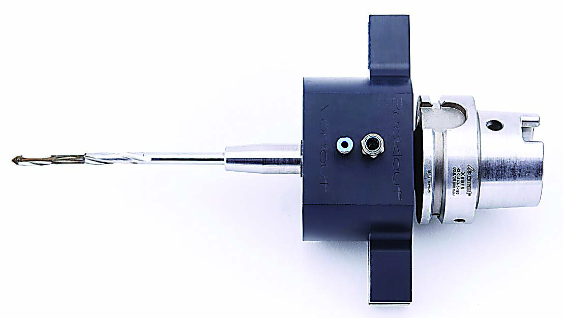

However, metal laser melting enables the manufacturing of drills with integrated cooling ducts. These ducts allow coolant to flow inside the tool—along the helix and back to the toolholder—without contacting the wound. Toolcraft, which manufactures tools, parts, assemblies, molds and injection-molded parts, also developed a nonrotating,
prespindle attachment with an inflow and outflow function for the coolant. As shown in the drawing on page 10, a continuous supply of coolant—water—is ensured by the attached coolant reservoir and pump.
The prototype was modeled on a conventional 6mm-dia. (0.236″) bone drill. The shape of the drill had to be kept the same to make it easier for surgeons to adapt to the new tool. It was also important that the tool material be biocompatible, and, therefore, 1.4404 stainless steel was selected. Internal cooling ducts are 1.2mm (0.047″) in diameter and remove heat from the cutting edge. Coolant enters and exits the drill via horizontally drilled holes. To attach the manifold—the sleeve housing the drill—there are grooves for circlips. The two chambers in the manifold are sealed.

The internally cooled bone drill. Image courtesy of toolcraft.
At the outset of the project, the cooling capacity was determined in terms of the volumetric flow rate and temperature and thermal capacity of the coolant. A cutting speed of 2 m/min. (6.56 sfm) and a volumetric flow rate of 290 ml/min. (9.8 oz./min.) were recommended, with a feed rate from 0.07 to 0.35 mm/min. (0.002 to 0.0138 ipm).
The project team then developed a method for bringing a closed cooling circuit into the tool substrate while maintaining tool stability and ensuring that the tool was suitable for performing the required processes.
After the drill was 3D-printed by Concept Laser GmbH, Lichtenfels, Germany, it was ground to final size.
Using water as a coolant, IFW drilled and measured the process temperature in artificial and bovine bones. The researchers measured reference temperatures at higher and lower feed rates and when the tool cooling system was turned on and off. With the cooling system off, the temperature was more than 60° C (140° F). With cooling deployed, the temperature was less than 40° C (104° F).
