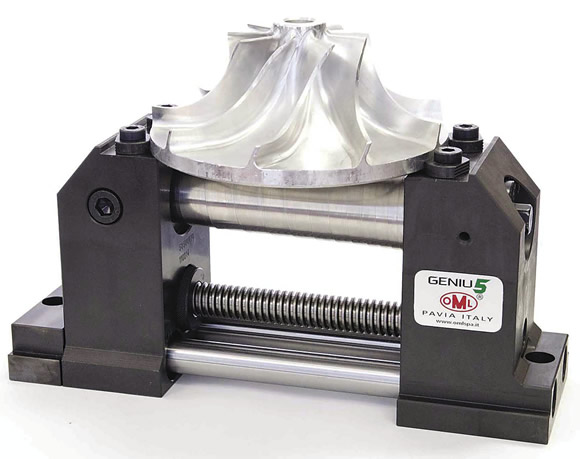

Vise for 5-axis milling on trunnion tables
OML’s Genius vise for 5-axis milling in trunnion-table machines is available from Lexair Inc. The vise reportedly maximizes clamping force at the top of the jaws by pulling them closed with a collapsing lead screw, while holding the bottom of the jaws in place with an opposing force screw. By holding the vise jaws apart at the bottom and pulling them closed at the top, the vise pulls the workpiece down against the stops as closing force increases. The vise is available in two sizes and can hold parts with a maximum clamping force of 9,000 lbs. According to the company, the vise secures odd-shaped workpieces, such as turbine blades and blisks, and presents them to the spindle with minimal obstruction, reducing setups and ensuring repeatability of 0.0008″.

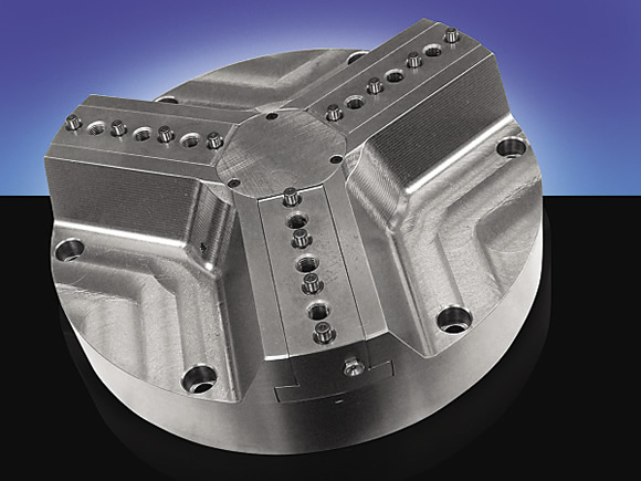

Northfield Precision Instrument Corp.’s Model 1000 10″-dia., 3-jaw air chuck was customized by milling the chuck face to reduce the weight by 15 lbs. According to the company, the standard chuck normally weighs about 60 lbs. and the lighter weight helps maintain the accuracy of the machine. Northfield Precision Instrument designs and manufactures air chucks for lathes, boring machines, grinders and vertical machining centers, with accuracies from 0.001″ to 0.00001″. Chucks are available from the company in SAE or metric styles from 3″ to 18″.

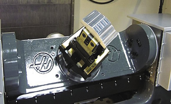

Mitee-Bite Products LLC’s Loc-Jaw workholding system is for 4- and 5-axis machining. The rails and gripper towers are serrated to provide a solid and easily adjustable base, according to the company. The system has a clamping range from 0.5″ to 4.0″, is capable of penetrating 0.060″ into the part per gripper and produces more than 6,000 lbs. of holding force. The low-profile grippers hold only 0.100″ of material. This allows full access to work surfaces, including the bottom face. A centering disk can be mounted to the base bottom for quick location on faceplates with a centering hole. The base is also configured with two drill bushings for precise locating using the included diamond and tapered pins.
