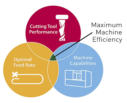

Typically, production cost centers are evaluated independently, including tool, raw material, capital equipment and manpower costs. However, incremental savings in each typically don’t add up to significant gains. My contention is that the areas of cutting tools and CAM, particularly software that has newer toolpath-generation technologies, along with machine capabilities, must be looked at concurrently. The goal is to hit the optimized sweet spot of all three—referred to as “machining effectiveness”—to significantly reduce production costs.

Illustration courtesy CNC Software.
Optimal material removal and cutting tool performance occur when CNC machines are programmed using newer CAD/CAM software. This technology continually maintains the cutting tool manufacturer’s recommended cutting conditions and chip load, regardless of part geometry. High material-removal rates, with predictable and long tool life, significantly reduce cycle times and production costs. This is necessary for achieving machining effectiveness. In addition, improved mrr and tool life can be realized with virtually any tool, because these newer toolpath strategies are based on consistent cutting conditions.
