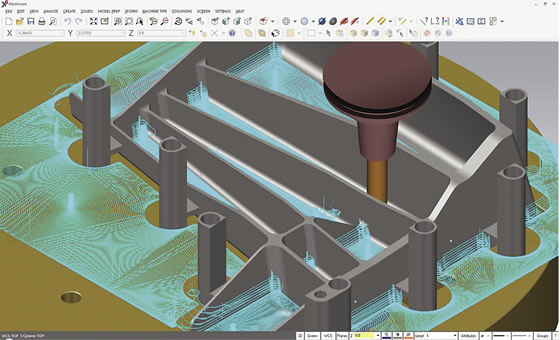

High-speed machining using Mastercam’s Dynamic Motion Technology is shown here in combination with the advanced tabs fixturing for fast transitions between top and bottom side machining. This allowed Five Axis Industries to improve in its metal-removal rates by up to 70 percent. Image courtesy CNC Software.

An early project he worked on was a difficult part that was consuming 8 hours of machining time and leaving a trail of broken cutters in its wake. Koger was familiar with Mastercam’s Dynamic Motion technology, a version of constant chip load machining, and he applied it to the job.
“The goal was to make these parts as fast as possible without breaking a cutter,” said Erik Ellstrom, president. “The machine cycle was reduced to a little over 3 hours and there were no broken cutters.”

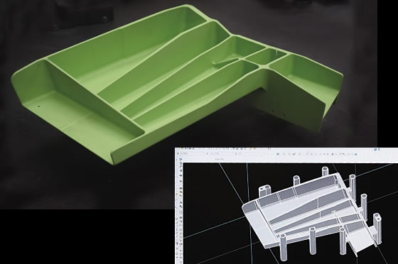

Five Axis Industries has improved mrr by about 60 to 70 percent on a part like this by incorporating Mastercam’s Dynamic Motion technology, which enables cutting with full-flute engagement at high speeds and a constant chip load. Image courtesy Five Axis Industries.

Although reducing tool costs was its primary objective, the company soon learned that Dynamic Motion toolpaths also improved the mrr. He estimated that using Dynamic Motion for roughing and applying the same tool for finishing cut run times by 60 to 70 percent.
“Based on the material we are running and the cutter specs, we know what the max chip load is, so we will run as fast as the carbide tool will allow us and vary the engagement to keep the chip load constant,” Ellstrom said. “With titanium, we’ll run 425 sfm with a 0.0067 ” chip, using a 5-flute endmill. With this approach, a 2-hour job can easily become a 40-minute job.”
