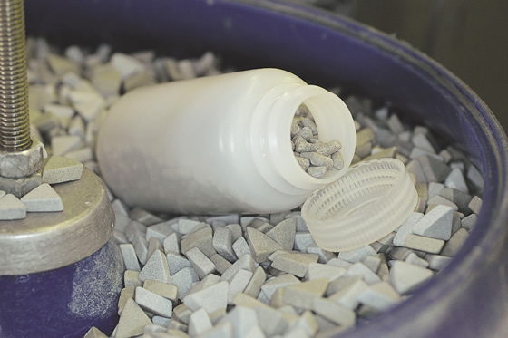

■ For really small parts, you can use a subcontainer inside the main bowl. This prevents tiny, gray parts from becoming hopelessly lost in a sea of tiny, gray media. It’s also a neat trick to allow you to switch media sizes and shapes without having to dump 300 lbs. of abrasive to find one little part.
Ch12.Fig055.Lipton.DSC_7193.tif

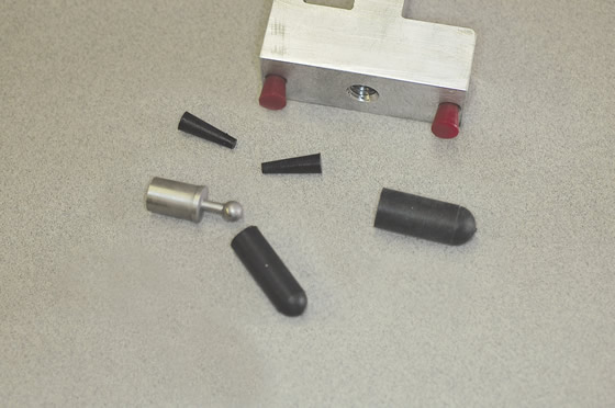

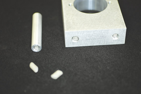

■ Mask features you want to protect or keep sharp while the rest of the part goes through the vibratory tumbler deburring cycle. Plastic or rubber caps and mesh sleeves used to protect shafts work great for masking. You can also use small silicone plugs for masking holes you don’t want media to enter.

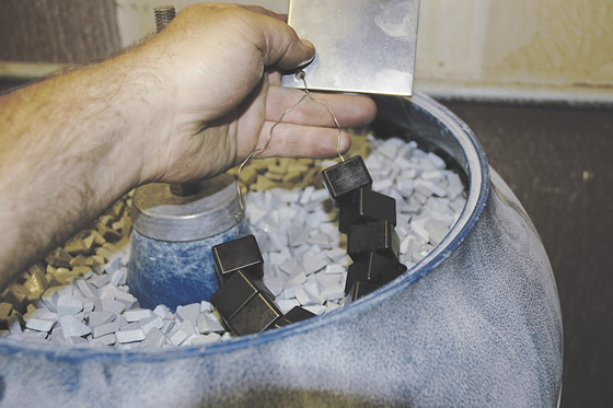

■ To make small parts easier to retrieve from the tumbler, secure them to a leash of sorts. I use stainless steel tie wire and a large “flag” that I can easily spot when I open the lid. This cuts down on the inevitable search-and-count associated with tumblers without part discharge devices.
