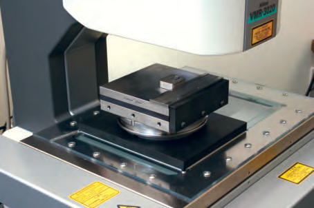

Courtesy of Plastic DesignA micromold machined at Plastic Design is positioned on a Hermann Schmidt magnetic chuck mounted on a unit of System 3R's Nano reference system.Shop takes 'systems' approach to holding microparts.Accurately machining and measuring a part requires it to be located and clamped with precision that matches or exceeds specified final tolerances.

A micromold machined at Plastic Design is positioned on a Hermann Schmidt magnetic chuck mounted on a unit of System 3R’s Nano reference system.

Plastic Design Corp. (PDC), Scottsdale, Ariz., deals with those challenges every day. The company manufactures molds and uses them to produce small medical devices, microfluidic circuits and in vitro lab ware.
“We are cutting true microcavities,” said PDC President Mark Kinder. “Typically, we are doing one- and two-cavity tools; a luxury for us is a four-cavity mold. In the case of microfluidic devices, he said, “the X-Y of the cavity may be pretty big—3 “×5 “—but we are cutting features in the 30µm to 50µm range.”
Machining features as small as 10µm, he said, “is no big deal.” However, there are many variables that affect the shop’s ability to consistently generate those tolerances. For example, all rotary chip-removal systems feature some degree of spindle whip. “When you bring the machine up to speed, the centerline shifts subtly,” Kinder said. “It’s a centripetal phenomenon. The better the spindle, the less there is, but it occurs. We’ve mapped all of our machines. We can predict it, but it is never an exact thing. It’s subtle—tenths (10-thousandths of an inch) or microns.”
In consideration of that and other variables, Kinder regularly checks part dimensions while machining. The parts are taken from a vertical machining center or EDM to a Nikon NEXIV VMR-3020 optical/laser 3-D coordinate measuring machine, inspected and returned for re- machining, if necessary. The actual steps followed are dictated by a shop’s familiarity with, and confidence in, a specific operation, as well as the tolerances of the part being machined.
“If we have a high level of confidence, we will make the cut and check the part just for verification,” Kinder said. If the part is out of specification, it’s either scrapped or, if possible, refixtured for further machining.
On the other hand, if tolerances are especially tight, Kinder said he takes a different approach. The initial CAM program is written to cut the part to slightly larger-than-final dimensions. Then the part is inspected, the program is adjusted and the part is refixtured for machining to final dimensions.
For that reprogramming and remachin-ing to be accurate, the part must be positioned identically for measurement and machining. About 2 years ago, PDC was having trouble repositioning work after removing it for inspection. “When you get down to splitting tenths, measuring the part is difficult enough,” Kinder said. “But getting it back into a location where we could take a 0.00004 ” (1µm) cut is where we were really struggling. We were spending 2 hours on a good day, and 4 to 5 hours, on average, getting the block trammed back into the machine.”
A palletizing system might eliminate much of the time spent repositioning the molds, Kinder observed, but standard systems didn’t provide accuracy high enough for his needs. Then he saw a demonstration of the Nano referencing chuck system from System 3R USA Inc., Elk Grove Village, Ill. “Repeatability was basically unmeasurable,” Kinder said.

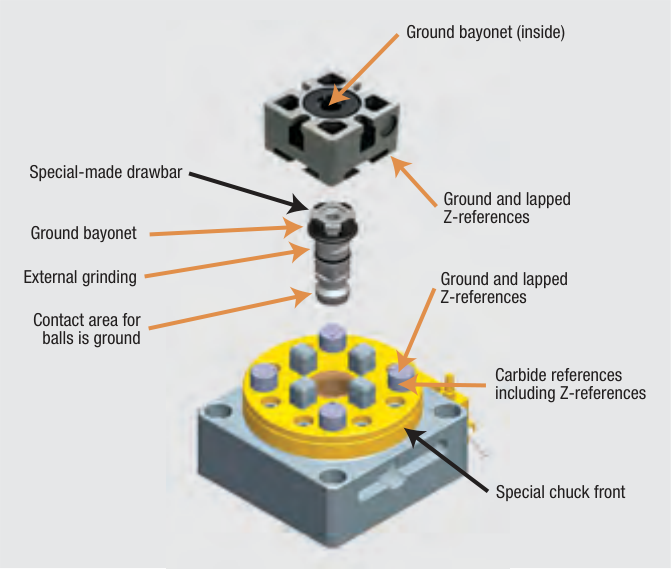

Jack Sebzda Jr., System 3R Northeast regional manager, said the Nano system is a “tweaked and finessed version” of System 3R’s standard Macro chuck system. “We take standard chucks out of the production line and basically balance and blueprint them, sort of like they do to an automobile engine to improve its performance,” Sebzda said. “The chuck is hand-lapped and hand-measured; everything is done with the goal of making it as accurate as possible.”
For example, he said, instead of being simply rough milled and tumbled, the locking surfaces of the pallet drawbar are ground so those dimensions are consistent drawbar to drawbar. “It’s overkill for what you might normally expect, but we want the same exact pull force to be exerted on the pallets every time,” Sebzda explained. The result is repeatability better than 1µm, he said.
NanoVersion.ai
Courtesy of System 3R
The Nano reference system’s chuck components are ground and lapped to maximize accuracy and produce repeatability better than 1µm, according to the company.
Kinder enlisted his workholding supplier, Hermann Schmidt Co., South Windsor, Conn., to integrate Schmidt’s workpiece-holding chucks with the System 3R palletizing system.
PDC required precision vises and different styles of magnetic chucks for its machining center and EDM, said Peter Schmidt, president of Hermann Schmidt. The company provided 6 “×6 ” magnetic chucks ground to better than 0.00005 ” square. When mounting the magnetic chucks to the System 3R pallet chucks, Schmidt said, “We indicated the rail around the outside of the magnetic chuck (against which the part rests) from the centerline of the System 3R reference chuck, so that in multiple chucks the work offset is within 0.00003 ” square and parallel from the center location.”

Palletizing is a long-established technology and most suppliers will guarantee their products to repeat within 2µm. However, while 2µm repeatability is good enough for most applications, “Mark Kinder’s world is a whole other step higher,” Schmidt said. “Mark wanted to take a pallet out of one machine, put it in another machine and repeat to 1µm or better. We are talking about going from 0.00008 ” repeatability in one machine down to 0.00004 ” repeatability machine to machine.
Hermann Schmidt takes the prefinished chuck and bolts it to the referencing system. When two objects are bolted, they are stressed, so at some point in the process one of the surfaces is lightly machined to qualify it. For example, the flat plate on the back of a magnetic chuck will be requalified via grinding and lapping.
PDC just had to mount the chucks and tram them in. “It has become our standard workholding system,” Kinder said. The pallets are installed on PDC’s VMC, sinker EDM and CMM. Some hold magnetic chucks, some grinding vises and some System 3R electrode holders. After initial machine setup, no further setup is required.
