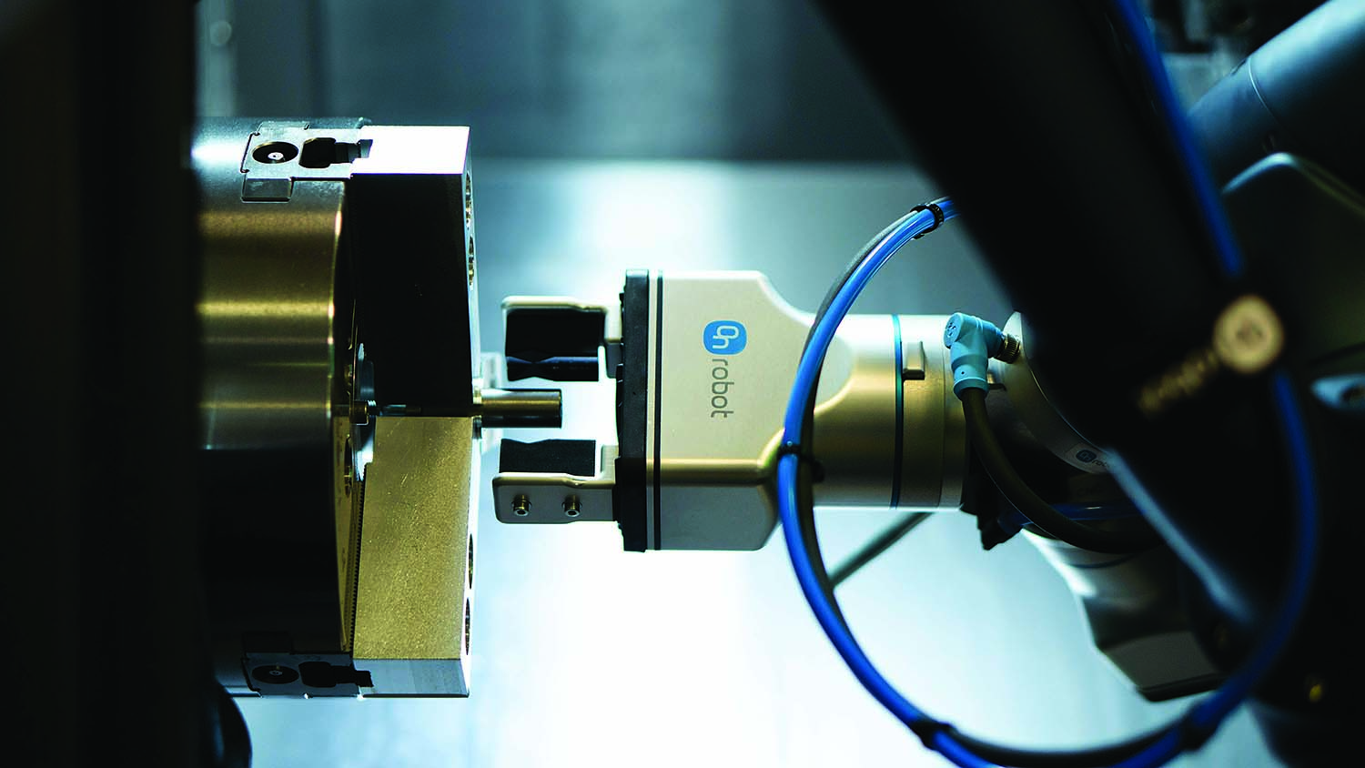

BS CNC selected two OnRobot 2FG7 electric finger grippers with the Dual Quick Changer paired with a collaborative robot from Doosan Robotics Inc. OnRobot’s seamless integration with the Doosan cobot allowed the team to quickly get the system up and running using the familiar Doosan robot teach pendant interface
The compact OnRobot 2FG7 electric finger gripper offers flexible gripping for a wide range of part sizes and shapes. Image courtesy of OnRobot Americas“>
Unlike custom grippers, the 2FG7 parallel finger gripper is reportedly easy to set up and run, handling the variety of parts needed and requiring no additional engineering or maintenance that would otherwise drive up costs. The gripper is well-suited for machine tending tasks because of its compact design and reliability in challenging manufacturing conditions where equipment is exposed to splashing water, oil and coolant. BS CNC boosted productivity by mounting two grippers in the Dual Quick Changer, allowing the robot to load and unload parts in one pass.
Before automating, the company typically produced 128 parts per shift. That increased to 155 parts per shift, for a 21% productivity improvement, Sándor said. “With the new solution, we have assured our CNC machines are always operational, enabling us to enhance our production hours by four.”
