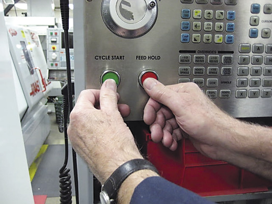

■ Reduce the “rapid” speed (G00) during setup and debugging by activating a lower rapid-speed percentage button. This is a precaution that gives you more time to hit the feed-hold button if something doesn’t look right. I often use these lower percentages during setup and debugging, especially when machining expensive parts.

A machinist should toggle between the cycle-start button and the feed-hold button as the cutter approaches the part. If there is a programming error, the machinist is in a good position to catch the error before any material is cut. All images courtesy J. Harvey.

■ For first runs and debugging, toggle between the cycle-start button and the feed-hold button on the controller as the cutter approaches the part. It is difficult to see where a cutter is in relation to a part when the spindle is at machine Z zero (retracted). The closer the cutter gets to the part, the easier it is to see the relationship between the part and cutter. Sometimes I toggle half a dozen times when a cutter is on its way down, especially when engraving expensive mold cavities.

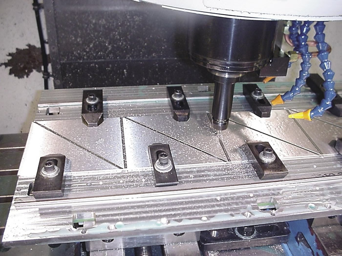

Tie-down clamps are something that a tool can easily run into. When using tie-down clamps, program with generous rapid planes.

■ Be extra cautious when using tie-down clamps. Except for simple setups, I try to avoid using tie-down clamps unless I know there is little chance of having a tool run into them. Besides just sticking up in harm’s way, machine operators frequently place the clamps inconsistently. Instead of using tie-down clamps, I prefer bolting parts down. I try to avoid special programing that may be needed to “jump” over clamps. These special programs can be nightmares for someone trying to set up the job at a later date.
■ Be cautious of protruding bolt heads. With bolts, a default rapid plane of 1″ is usually adequate to jump from one location to the next without having to concern yourself with interference—as long as the bolt heads don’t stick up higher than the rapid plane.
