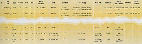

Our lists pack a lot of information onto each line (Figure 1). Every tool is assigned a number that is referenced on each setup sheet. Tools are arranged by type, in alphabetical order. Spaces are left between each group of tools to allow for the addition of new tools. After specifying the type, tool diameter is given, followed by the pocket that the tool occupies in the chain.
Back Off
Figure 1: Compiling detailed lists about tools and their optimal cutting parameters helps to make machining processes more consistent. Programmers can use the lists to specify speeds based on historical data, not guesses.
The next two columns indicate the rpm and ipm that have proved to work best. This data tells everyone how a particular tool should be run. Programmers, manufacturing engineers, supervisors and operators can all see what speeds and feeds were used to set up a process.
Another important bit of information that we include is which part or parts a particular tool is used for. This makes it easy to see what impact changing a tool has on other processes that run on the same machine. For example, switching to an extended-length holder may be acceptable on some parts but not on others.
The lists include the manufacturer and vendor for each tool, as well as the manufacturer’s part number. Some items have our own part numbers assigned to them, which lets us order them via our electronic purchasing system.
We also include information about the type and size of holder required for the machine, as well as the insert or collet—depending on the tool type—that has been specified by our manufacturing-engineering department.
