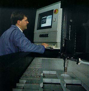

Because of the system’s easy-to-understand interface and automated functions, even an operator with little specialized training or experience can make successful and accurate cuts using AWJ. To cut a part using the software, the operator enters data about the material and its thickness through a graphical interface. Data describing other process variables are passed to the system through a setup file that the operator can modify when necessary. The operator can enter part dimensions and geometry with a drawing program that is part of the system package. The software also can import CAD files that are in data-exchange format.
As the operator is entering part information, he can also assign a quality level to each segment of the part drawing. This quality setting guides the system in its choice of traverse speeds for that section. Higher quality settings prompt the system to choose slower speeds. To calculate the optimal tool-path and machine settings, the system automatically feeds all of this information into an empirical mathematical model of the cutting process that was created using data gathered from a series of cutting tests. This model can predict the behavior of the stream in a wide range of materials, taking into account the effects of process variables and machine limitations.
An operator can achieve extremely accurate results when a PC running this software is used to control a high-performance AWJ machine. This combination of controller and hardware can be found in integrated systems now on the market. Such a system, which includes a PC to run the controller, sends up to 6,000 speed and motion instructions per second to a machine equipped with an ultra-high-pressure pump, an AWJ delivery system, and a precise 2-axis machining table. Shops use the system to cut complex parts out of metal, plastic, glass, composites, and ceramics to a dimensional tolerance of ±0.005″. The system can contour flat materials up to 2″ thick directly from a 2-D CAD or vector-based drawing system. An expert system that can analyze the part and generate the most efficient tool path is also part of the software. With all of this power so readily available, operators can go from drawing to finished part very quickly.
