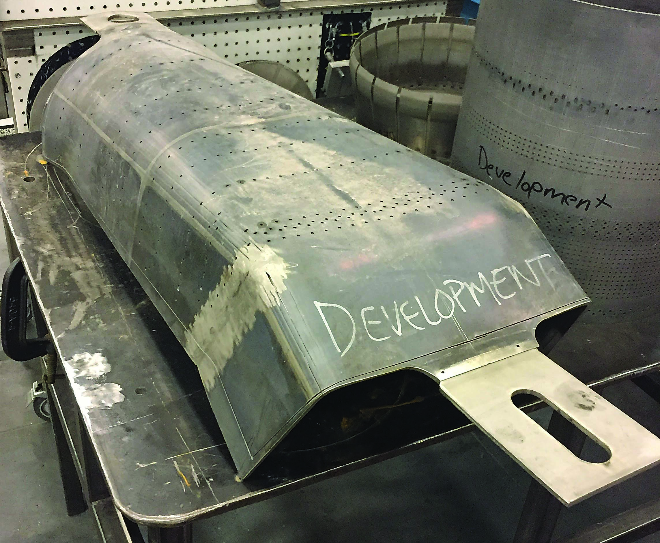

Pictured is the lower half of a gas turbine combustion component. The rectangular tabs and extra stock must be removed, which is done with a 5-axis abrasive waterjet machine at Mitsubishi Hitachi Power Systems Americas. Image courtesy of C. Tate

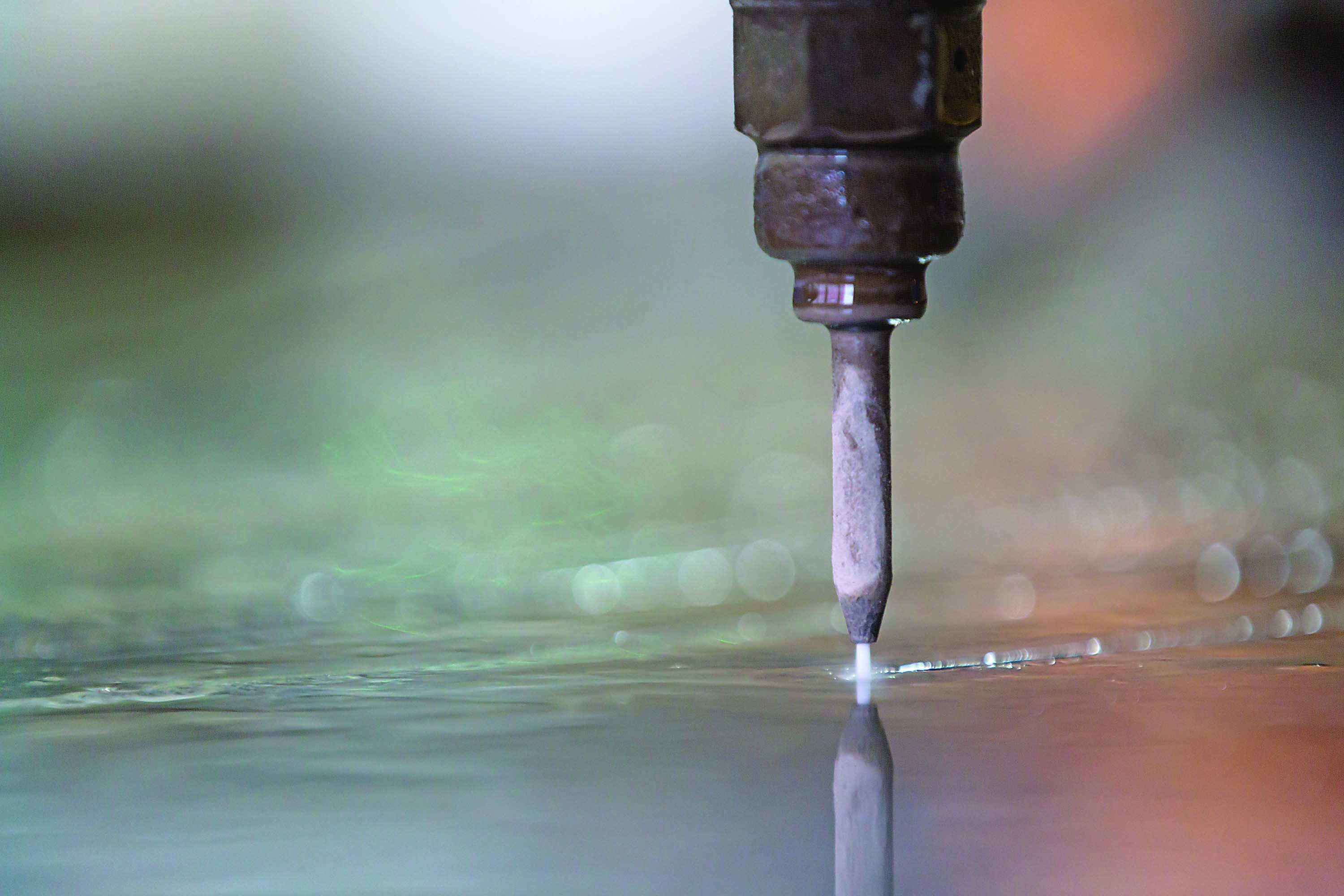

Waterjet machines pressurize water to very high pressures, with 60,000 psi being common. Some machines are capable of even higher pressures. The pressurized water is presented to a small-diameter orifice, and the restricted flow combined with the pressure create a jet that can travel four times the speed of sound.

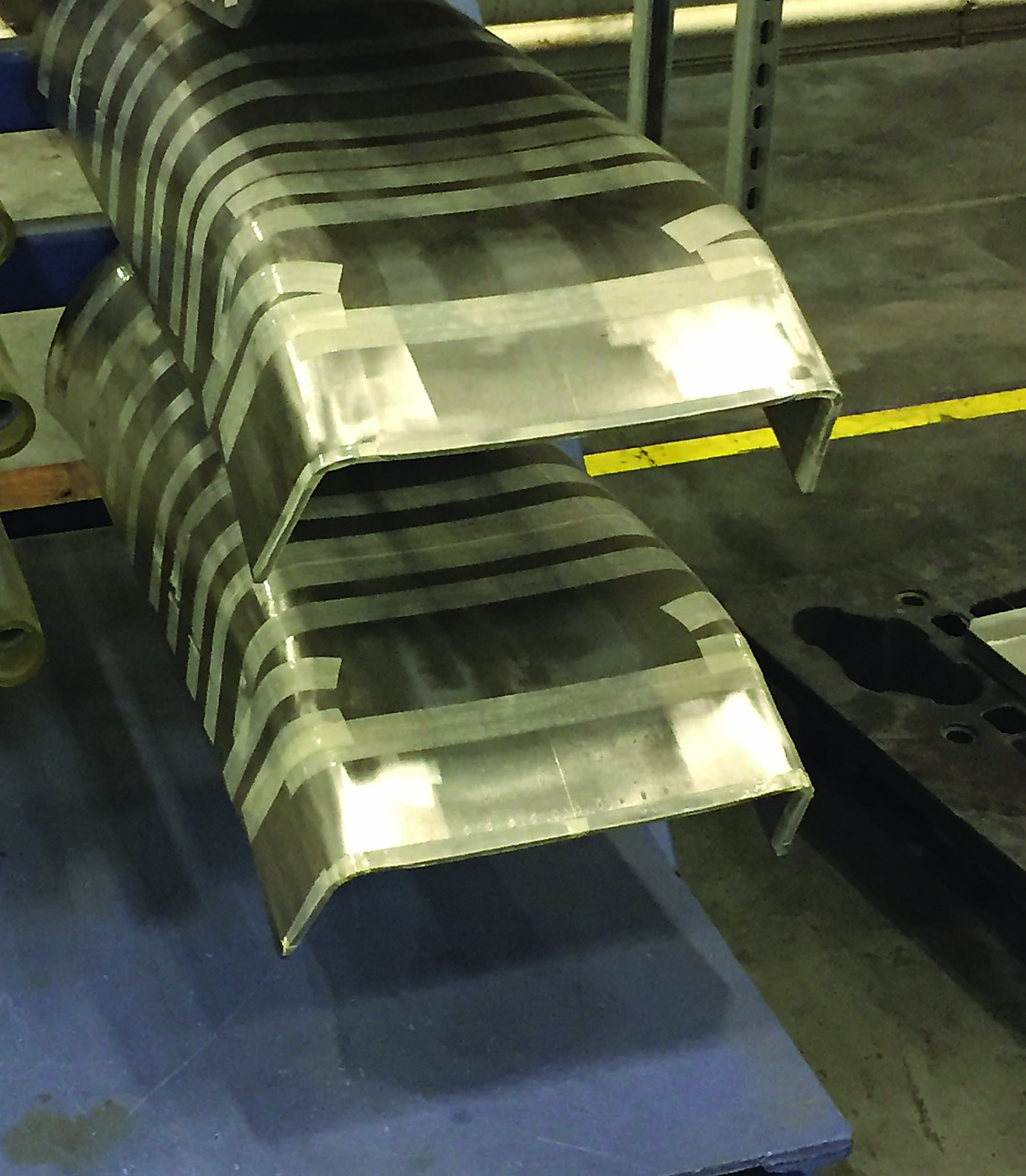

These parts have been through the waterjet machine and are ready for laser welding. Because waterjet cutting does not create a recast layer, no grinding or sanding is needed to remove one. Image courtesy of C. Tate
