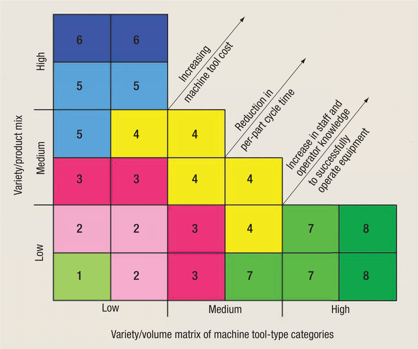

The machine tool selection process starts with the big picture—the amount of part variety and the volume (production rate) that you need to produce. As a first step, examine the parts, part families and processes that will run on this machine. If you are selecting a machine to consolidate other machine tools, look at the history of parts made, not just the recent ones.
Machine tool selection categories can be divided into eight classes (see diagram on page 69). This diagram is adapted from the traditional part mix/volume matrix. The diagram is not by process, such as turning or milling, but by the available processes, operational features and machine complexity. Additionally, the machine tool categories that are further away from the graph’s origin typically cost more to buy and operate and require the use of more complex machine tool systems to fulfill production. Use this diagram to begin to determine where you should be in terms of the machine tool category and whether your company is a good fit within this category.
When you need high-variety production, high-volume production and a series of secondary operations, no single machine tool can meet that need. Choosing the right mix of machine tools can make your shop more efficient and productive than your competition. CTE
