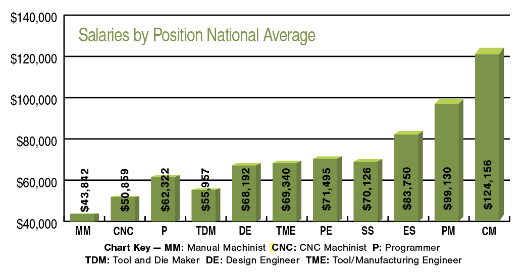

Based on our 2024 survey results, just two positions saw an increase in pay compared to our 2022 survey results — tooling and manufacturing engineers and shop supervisors. Tooling and manufacturing engineers reportedly make $69,340 a year on average nationally, while shop supervisors make $70,126. The salaries represent a 0.8% and 2.0% increase in pay, respectively, since 2022.
The salary and corresponding percentage
decrease in pay since 2022 for the remaining positions follows:
Manual machinist — $43,842, down 4.2%,
CNC machinist — $50,859, down 2.8%,
Programmer — $62,322, down 0.3%,
Tool and die maker — $55,957, down 5.4%,
Design engineer — $68,192, down 3.7%,
Project engineer — $71,495, down 3.3%,
Engineering supervisor — $83,750, down 2.3%,
Plant manager — $99,130, down 2.2%,
Corporate manager — $124,156, down 8.6%.

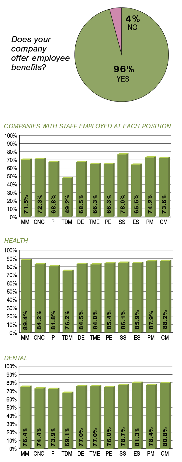

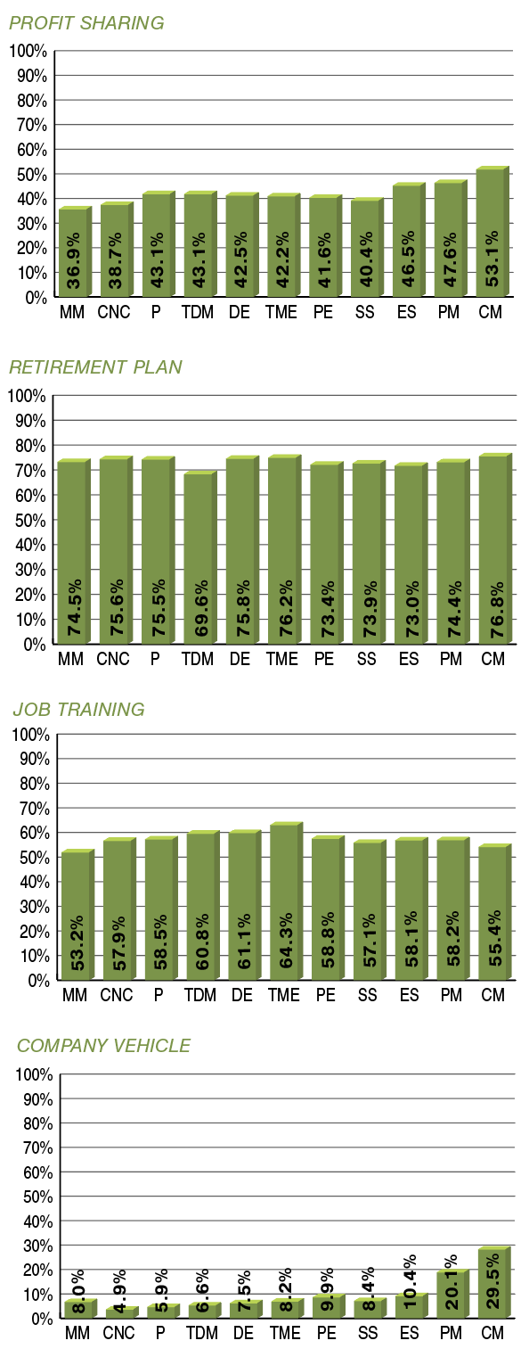

As usual, our biennial survey also provides a snapshot of what benefits are offered to manufacturing workers at each position. Among the respondents, 96% said they provide benefits of some type to their employees — a result that has not fluctuated much in the past several biennial surveys.
That said, this year CTE has changed the way we calculate the percentage of companies offering a particular benefit at each position. In the past, this percentage was calculated by dividing the total number of companies that offer, for example, job training to CNC machinists by the total number of companies responding to the overall benefits question.
Instead of dividing by the total number of companies that respond to the benefits portion of the survey, CTE now calculates the percentage of companies offering, again for example, job training to CNC machinists by the total number of companies that employ CNC machinists.
While this approach doesn’t mean companies are suddenly offering more benefits to more employees than 2 years ago, it should reflect a truer picture when you compare one position to another.
For instance, just 37.1% of companies reported offering a health plan to tool and die makers in 2022. That’s quite a bit below the percentage offering a health plan to each of the other positions.
By taking into account that not all of the companies employ a tool and die maker, CTE can report this year that 76.2% of the companies that employee tool and die makers offer a health plan to them.
By the way, 49.2% of all the responding companies indicated that they employ tool and die makers. For more on the makeup of our 2024 survey sample, see “About Our Respondents” below. For more about how we conducted this year’s survey, see “Survey Methodology.”
