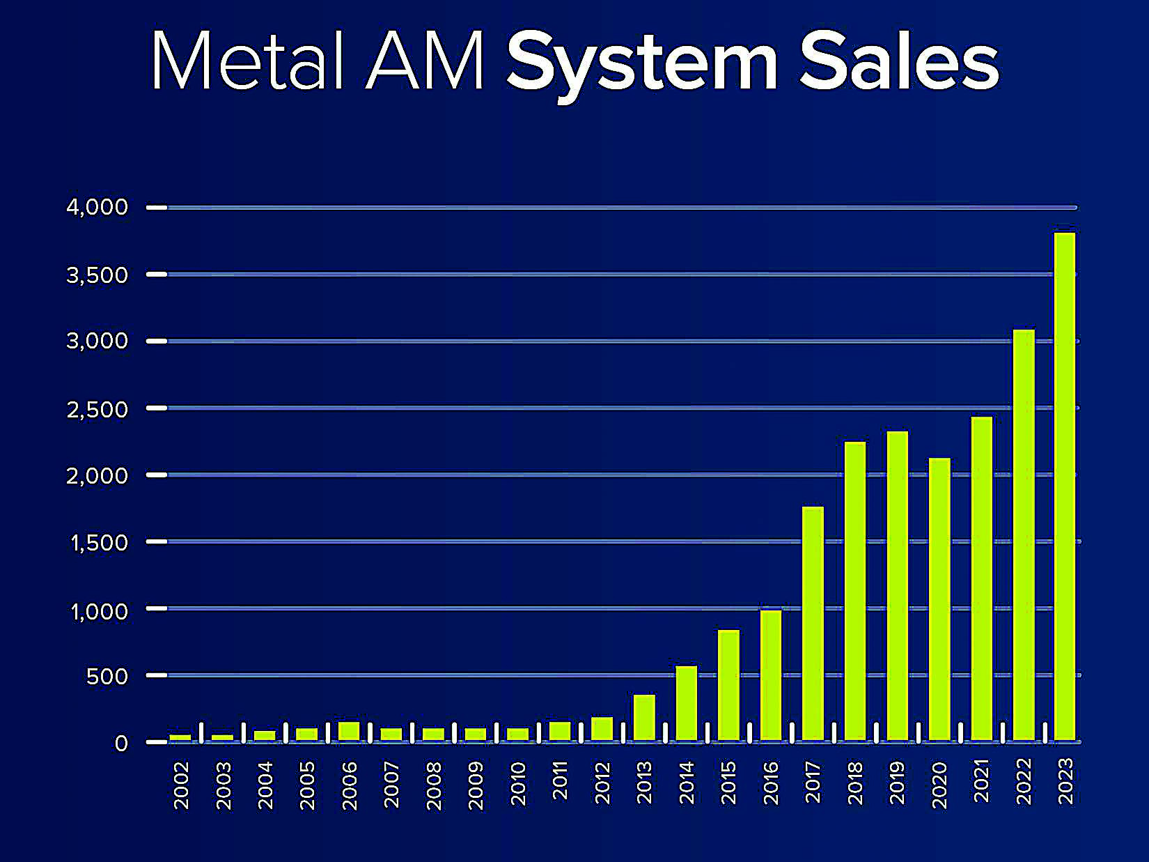

Metal AM system sales increased by 24.4% in 2023, with an estimated 3,793 machines sold, according to “Wohlers Report 2024.” Image courtesy of Wohlers Associates
What could really impact the AM industry, Wohlers noted, is when the automotive industry embraces the technology in a much bigger way. Currently, cost is a major consideration. One example of adoption by the auto industry is the Cadillac Celestiq electric vehicle, which has 115 polymer and metal parts that are additively built.
“Wohlers Report 2024,” the company’s annual report that tracks the AM industry, states that metal AM system sales increased by 24.4% in 2023, with an estimated 3,793 machines sold. The overall AM industry grew by 11.1% in 2023 compared to 18% in 2022.
Of the $3.65 billion worth of AM materials sold year last, Wohlers said 19.7% were metals. The most common metal AM process is powder bed fusion followed by directed energy deposition. “It’s still a distant second.”

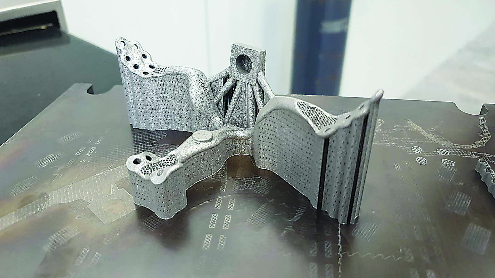

Robert Bush said he will leave the task of pinpointing where the metal AM industry is at on the adoption curve to others. He is focused instead on the common goal of making AM an economic, repeatable, scalable and productive manufacturing process. He is CEO of Rivelin Robotics in Sheffield, U.K., which is the lead partner of a U.K.-funded project to deliver a digital postprocessing solution for the automated finishing of printed parts called Project CAMPFIRE (Certified Additive Manufactured Parts Finished with Intelligent Robotics Engine). Rivelin is collaborating with five partners.
Postprocessing additive metal parts comes with many challenges — it’s labor-intensive, time-consuming, filthy and sometimes includes dangerous activities involved in removing metal supports with hand tools, Bush explained. The manual method is the most common because human workers have the needed dexterity, adaptability, flexibility and knowledge to make it the best option economically. “The people who do it are heroes. They are amazing. They are absolutely skilled.”
Nonetheless, a critical skills gap exists in the U.K., U.S. and other Western economies, Bush said, which became more pronounced after manufacturers based in the West moved production to low labor-cost countries and many later decided to reshore critical supply chains. In addition, manufacturers that can find skilled labor or train people, labor costs “have spiraled out of control” and safety and health regulations have become more stringent to better protect workers, which might not exist in lower-cost economies.
A 3D-printed maxilla facial plate from Attenborough Medical. Image courtesy of Rivelin Robotics
A solution is available, according to Bush. “You can be competitive with these lower-cost companies only if you harness automation.” Rivelin, for example, offers its Netshape robots to provide autonomous postprocessing capabilities. Rather than having humans wield sanders, angle grinders, grippers, hammers and other hand tools, a robot arm brandishes them instead, he said. With automation, part manufacturers can deploy existing workers to install and maintain the robots, and work on enhancing processes and continuous improvement, among others. “It can actually be adding more value and economic growth than just doing the same task over and over again.”

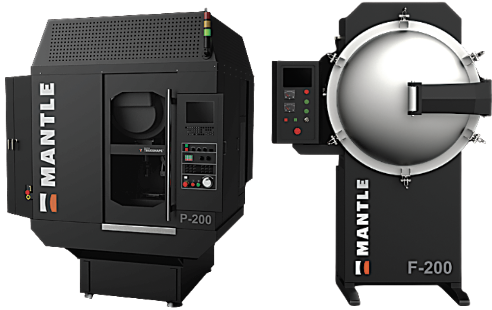

Mantle developed a different method of hybrid machining with its sintering-based process, Sorom said. Using the company’s metal pastes, which include H-13 tool steel, 420 stainless steel and still-in-development D-2 tool steel, a part is printed and shaped in the P-200 printer and then transferred to the F-200 furnace for sintering. “After 10 layers of printing, we come in and machine away the layer lines you’d normally see and refine the part using traditional machining techniques.”
Mantle’s hybrid system P-200 printer, which has a build volume of 200 mm × 200 mm × 150 mm, is a hybrid system that integrates 3D printing of the company’s metal pastes with machining. The F-200 furnace sinters those printed parts and solidifies them in durable, accurate components. Image courtesy of Mantle
However, the machining is not performed when the part is metal, but rather when it is comprised of metal particles with some binder, Sorom explained, like cutting rigid foam. “We can cut that material 10 times faster than you could cut traditional true tool steels. Yes, other technologies are capable of both additive and subtractive in the same machine, but on the subtractive portion when the material is hardened, it is slow and laborious.”
Once sintered, Sorom said the resulting metal is as durable and performs the same as traditional metal. The company reports that both H-13 tool steel and 420 stainless steel have a hardness of more than 50 HRC after heat treatment. In one application, an H-13 plastic injection mold produced about 3.3 million parts over the last 2½ years.
He noted that about 90% of the applications for the machines and pastes are for mold inserts and tooling and the rest is for thread forming dies, die cast tooling, stamping dies and extrusion dies.

Besides reducing the cost per part, Mantle’s hybrid system reduces the capital equipment investment, according to Sorom. The P-200 printer costs $230,000 and the F-200 furnace costs $120,000, which combined he estimates is about a third of the price of other systems on the market. All Mantle customers have purchased both machines, and one furnace can serve multiple printers.
Nonetheless, he said Mantle has made the strategic decision not to chase all universal applications, but rather focus on just tooling, where the company’s system excels. For example, a frame for an aircraft seat might have a generative design for lightweighting, and other methods of metal printing would be a better choice. In contrast, Mantle’s system is ideal for making parts like H-13 injection mold inserts and dies, and 420 stainless tooling for medical devices. “We don’t do everything, but the things that we do, we do them extremely well.”
