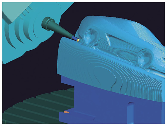

The system must reliably output NC data on nonproduction parts, such as tooling and prototypes. Many software developers make that claim, but care should be taken in evaluating if the system can provide reliable toolpaths, machining simulation, automatic tool changes, laser calls to validate tool wear and automatic selection of sister, or backup, tools.
A CAD/CAM system should provide virtual machining, or machine simulation, for planning, testing and optimizing toolpaths. All images courtesy Tebis America.
