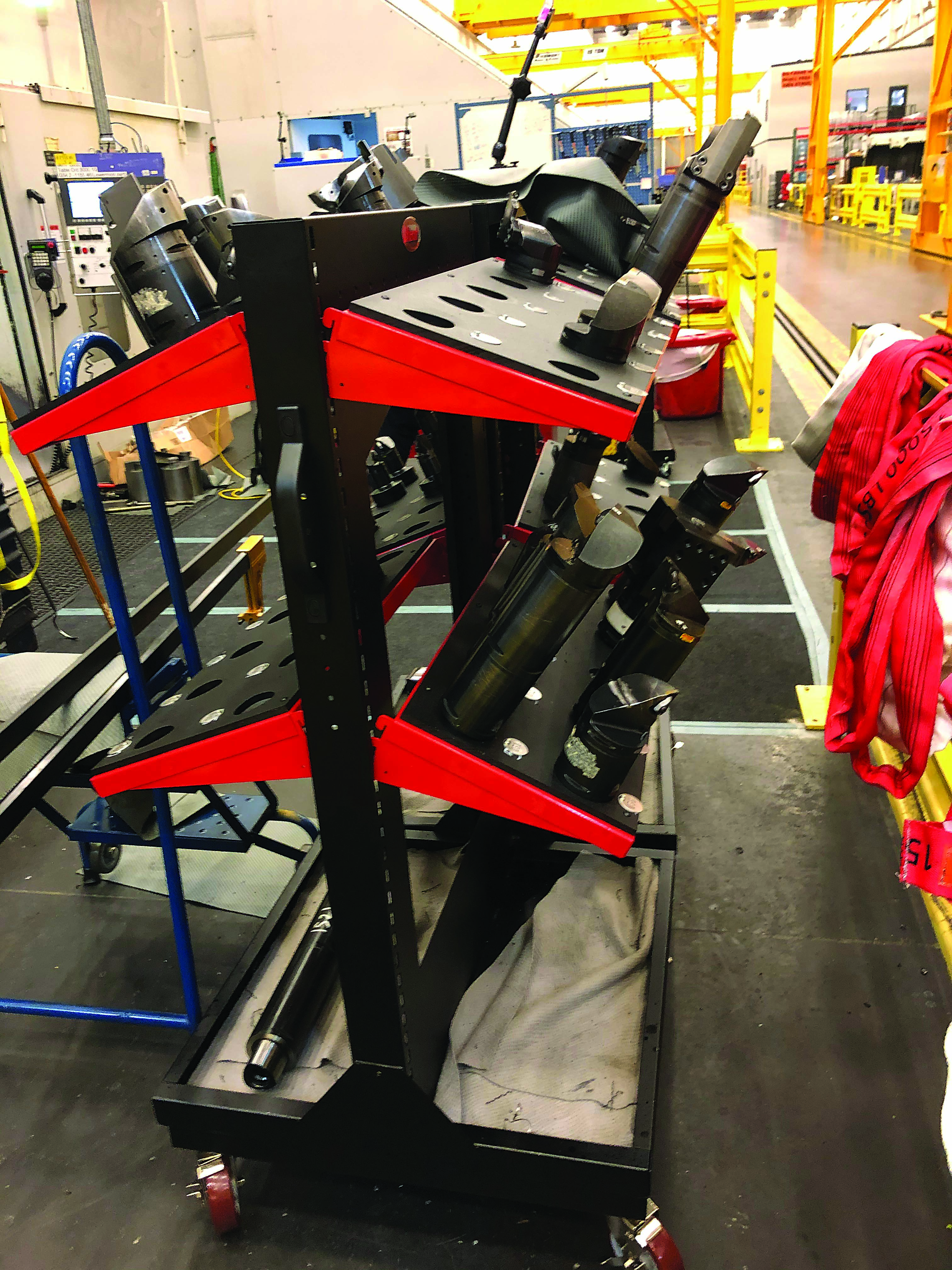

After investigating and testing several options on the market, we chose to adopt the Capto toolholding system for our VTLs because of its speed, accuracy, flexibility and availability.
Changing Capto tools is fast. Turn the actuating screw 180 degrees, and the holder is released. Replace it with a different tool, and re-tighten the screw. The whole process is complete in a few seconds, which is much better than the 20 minutes it had taken us to change a square-shank tool.
Accuracy was critical as our goal was to eliminate the need for machinists to set tools by touching parts and minimize the risk of entering incorrect data into offsets. Manufacturers say Capto tools can be removed and replaced with 0.002 mm (0.00008″) repeatability. This level of accuracy means we must set a tool only once when it is placed into service. Our roughing tools no longer need any adjustment after insert changes, so the opportunity to enter bad data has been reduced. Unfortunately, finishing tools still demand adjustments after insert changes, but we believe that it will be possible to end those adjustments in the future. Our ultimate goal is a machining utopia in which no adjustments are needed.
Each tool in the tool library is assembled, stored and ready for use. Capto toolholders allow workers to install tools in the spindle without having to reset tool data. Image courtesy of C. Tate
Cutting tools and toolholders are a significant expense at every shop, and creating a tooling system that works on all machines will reduce tooling costs. Capto holders offer a great deal of flexibility to shift tools from machine to machine. All our large horizontal lathes were purchased with a Capto interface, so when we adapted the VTLs to Capto, we immediately formed a system that allows us to share tool configurations between machines. This lowers the inventory of tools we keep and permits us to respond better to machines that are down or overburdened. Because 3D models of Capto tools readily are available, we have created a library of tool configurations in our CAM system, which lessens lead times for CNC programs and program verification.
