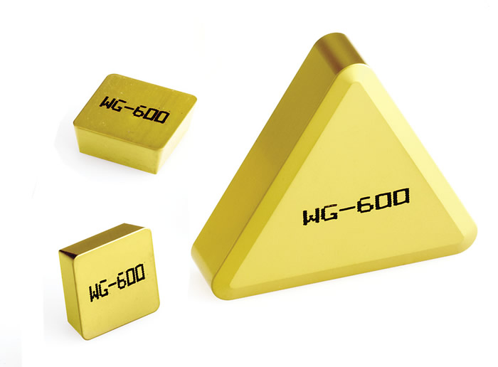

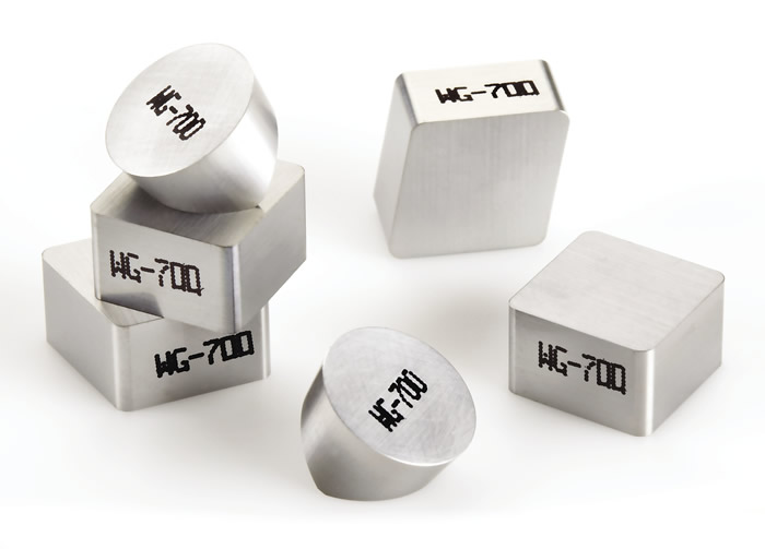

In addition, coated, whisker-reinforced ceramics introduced in the last decade provide additional time and cost savings compared to their uncoated counterparts. The addition of high-performance coatings increase an insert’s temperature and wear resistance, much like coatings on carbide cutting tools, and further boost productivity and tool life.
On average, by upgrading from an uncoated to a coated, whisker-reinforced ceramic tool, users can expect a 20 to 40 percent increase in cutting speed. And depending on the grade of the coated insert, up to a 20 percent increase in feed and up to a 50 to 100 percent increase in tool life can also be realized. In many applications, a coated grade imparts a finer surface finish and allows a longer length of cut than an uncoated grade.

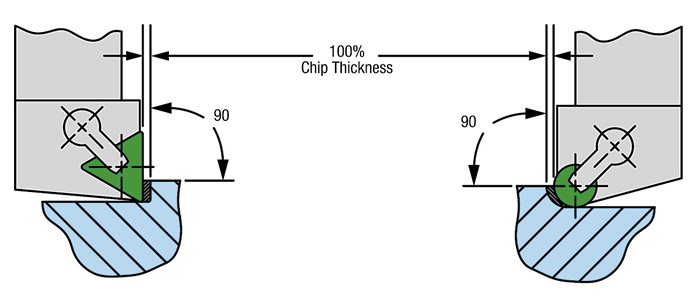

With a 0° lead angle for the tool, the chip thickness equals 100 percent of the feed rate.With a 45° lead angle for the tool, the chip thickness equals 71 percent of the feed rate.

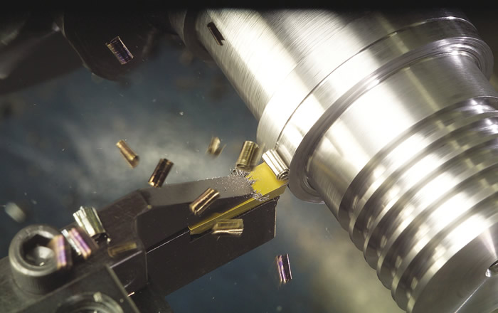

High cutting speeds are crucial for plasticization, or softening, of HRSAs, so material can be efficiently removed layer by layer. The plasticization process, however, generates a high level of heat in the cutting zone, which needs to be effectively managed and evacuated so the microstructure of the parent material is not compromised. Because of this, it is essential to properly balance the cutting speed with the feed rate and maintain the correct average chip thickness (ACT) to ensure the bulk of the heat is carried away with the chip.
The feed rate is expressed as ACT instead of feed per revolution or feed per tooth because the chip thickness can vary in relationship to the feed rate, depending on many factors. When applying a round insert, for example, the ACT depends on the DOC, because the effective lead angle changes as the DOC changes, varying the thinning or thickening effect on the chip.
When using a straight-edge insert, the ACT depends on the orientation of the tool to the part, otherwise known as the tool’s lead angle. While machining with a lead-angle tool can be beneficial for many reasons, such as reducing ceramic notching, it is important to adjust the programmed feed rate to account for these chip-thinning
phenomena and ensure a predictable tool wear pattern.
A rule of thumb for whisker-reinforced ceramics is to have an ACT of 0.002″ to 0.004″ (0.05mm to 0.10mm). This will ensure the chip maintains the proper cross section to carry the extreme heat developed by high cutting speeds from the tool/workpiece interface.

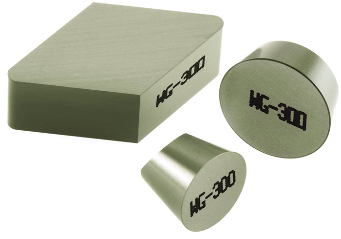

Greenleaf offers a variety of ceramic composite insert grades: WG-300 whisker-reinforced ceramic.
WG-600 coated, whisker-reinforced ceramicWG-700 coated, whisker-reinforced ceramicXSYTIN-1 phase-toughened ceramic

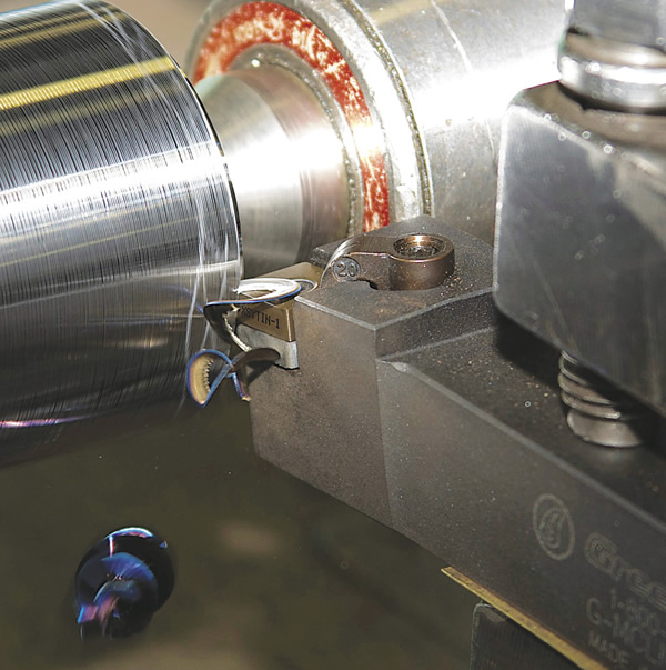

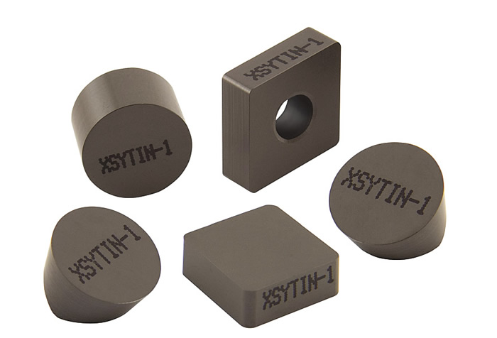

A new ceramic composite material that is gaining favor for turning and milling HRSAs is phase-toughened ceramic. Offering almost twice the strength of whisker-reinforced ceramics, this new ceramic composite can be run at the feed rates used for carbide inserts with the cutting speeds common with ceramic inserts. In addition, the increased strength of a phase-toughened ceramic tool can triple productivity, compared to other ceramic composite tools.
So far, the only phase-toughened ceramic available is Greenleaf Corp.’s XSYTIN-1. It is a thermally stable, whisker- and particulate-toughened silicon nitride with almost twice the strength of any other commercially available ceramic tool from Greenleaf.
The major benefit of phase-toughened ceramic is its ability to retain strength in demanding, high-force, interrupted cuts and excel in continuous cuts. Machining forging and casting scale and highly abrasive materials are just a few of the application areas these inserts are designed for.
It’s important to know that phase-toughened ceramic inserts cannot be run like other ceramics on the market; increased feed rates are a must. If the feed rate is not high enough, a high level of flank wear will occur, leading to premature tool wear. The ACT for phase-toughened ceramics is generally much higher than that of whisker-reinforced ceramics and many SiAlON (silicon aluminum oxynitride) materials.
XSYTIN-1 inserts from Greenleaf are made of phase-toughened ceramic, which has almost twice the strength of any other ceramic tool from the company.
