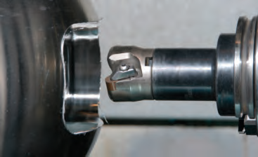

Courtesy of Ingersoll Cutting ToolsA grade-AS20 Si3N4 ceramic insert handles interrupted cuts when rough milling a pocket in an Inconel 718 valve ball. Advancements enable ceramic inserts to tackle difficult machining applications. If you still think ceramics are "too delicate" for anything but continuous cuts and finish passes, think anew.

For example, a valve manufacturer in Texas turns Inconel 718 valve balls four times faster with new unreinforced Si3N4 ceramic inserts from Ingersoll Cutting Tools than with carbide inserts and twice as fast as with any other ceramic insert the valve manufacturer tried. (Ingersoll also offers a new whisker-reinforced ceramic grade.) The valve manufacturer also improved the material-removal rate fivefold when rough milling compared to carbide and doubled the mrr vs. other ceramic grades. Moreover, the manufacturer is successfully boring Inconel—an application usually considered off limits for ceramics because of the high risk of recutting chips.
