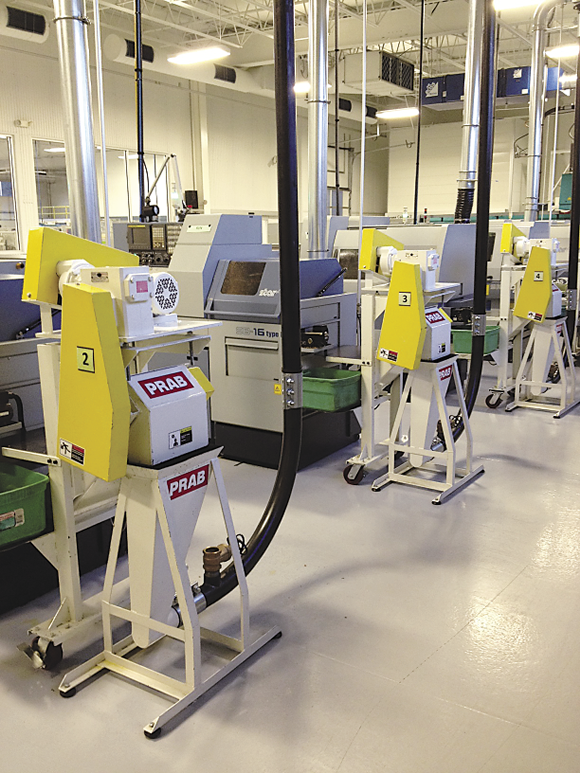

Bar-fed, Swiss-style CNC machines at Otis Technology once produced an oily mess of chips and fluid before the shop installed an automated collection system. Now, the shop floor is clean and safe. Chips from each of the company’s eight lathes are conveyed to individual hoppers (below), where they are extracted through pipes into a central centrifuge and storage bin.

Otis operates eight CNC Swiss-style machines. Chips exit each machine onto a conveyor that dumps them into a funnel-shaped hopper, which, in turn, feeds into a steel vacuum pipe that runs overhead. The unit at each machine turns on for a programmed time, and the vacuuming of chips proceeds down the line of turning machines as one unit is turned off and the next one turned on. Chips flow into a central centrifuge, which reclaims and filters the oil before it is returned to the machines.

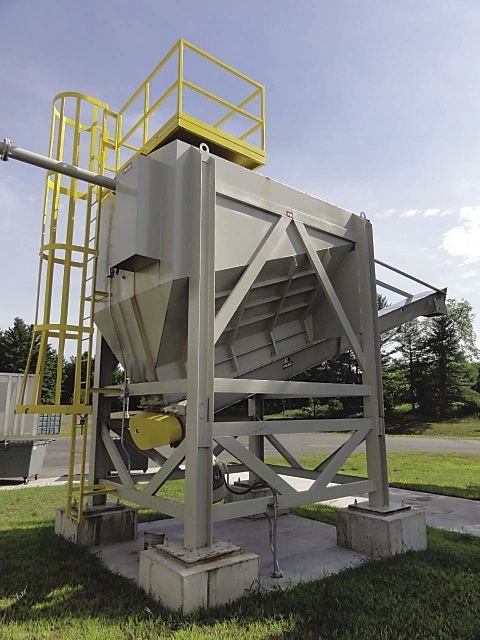

From the centrifuge, chips are transferred to a large hopper. When the hopper is full, which usually takes 2 days or so, a proximity switch is tripped and chips are spun out into a silo outside the shop (see photo on page 65). When the silo is filled, a recycler backs a truck under it and chips are augered into the truck, a process that takes about 10 minutes.

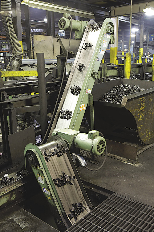

Eriez, which makes magnetic separation, metal detection and material- handling equipment, offers a combination conveyor and coolant cleaner to handle the job at each machine tool. Magnets attract and hold chips and fines while allowing coolant to drip through.

Ferrous chips open up handling opportunities for magnets, from separators to magnetic conveyors, such as this one from Eriez.

Otis Technology’s outdoor silo unloads brass chips into a scrap truck in 10 minutes.

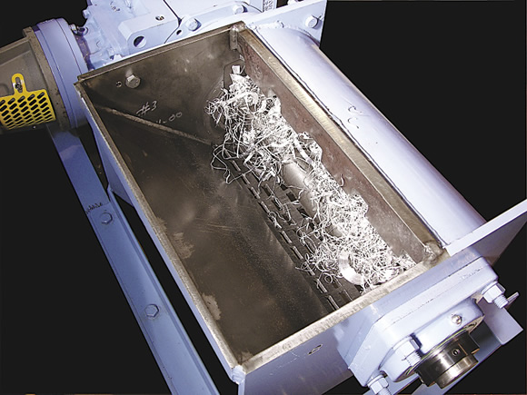

Courtesy of PRAB
Compactors are usually sized for large operations, but there are exceptions. This crusher from PRAB, dedicated to one machine or operated as a standalone unit, can compact 300 lbs. of chips per hour to 1/12 of their original volume.
