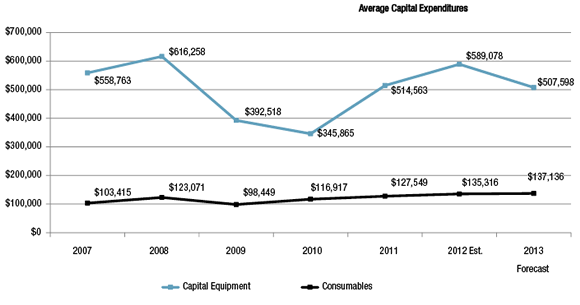

Courtesy of National Tooling & Machining Association
Capital equipment and tooling expenditures per individual job shop.

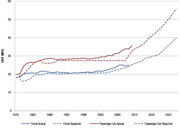

“CAFE (Corporate Average Fuel Economy) will change the normal but not as dramatically as feared,” he said, noting the regulations will be reviewed in about 5 years to see if they are achievable. “The power train that was low tech/low precision, is now high tech/high precision and goes to very high precision with the new regulations.”
Smith pointed out that the 2025 estimated CAFE for passenger cars varies for each manufacturer based on its fleetwide average wheelbase. For example, the compact Honda Fit has a 40-sq.-ft. footprint, a 30-mpg 2012 EPA rating and a 61.1-mpg 2025 target, and the full-size Chrysler 300 has a 53-sq.-ft. footprint, a 21-mpg 2012 EPA rating and a 48-mpg 2025 target. Fleetwide, Chrysler moves from a 2011 model year CAFE of 29.9 mpg to 55.6 mpg in 2025 while Honda goes from 36.0 mpg in 2011 to 57.0 mpg in 2025. However, the real-world estimate, the figure a consumer sees on a vehicle’s window sticker, is 80 percent of the target.
Light-duty truck regulations are lower, at just over 40 mpg, but may be harder to meet, according to Smith. “You may need an aluminum-intensive truck,” he said.
One way to improve fuel economy is to reduce vehicle mass, and the Department of Energy’s goal is a 10 percent weight reduction for the power train by 2020 and a 20 percent reduction by 2025. A 20 percent reduction for the complete vehicle will be required by 2020 and a 30 percent reduction by 2025. However, the mass of U.S. passenger cars has been trending up since the late 1980s, primarily because of the increase in comfort and convenience accessories.
Smith said the first step to downsize the engine is gas direct-injection technology “to make it act like a diesel,” which is used in Europe and Japan for efficiency and performance. Other mass reduction technologies for internal combustion engines include turbochargers, superchargers and cylinder deactivation.
Courtesy of EPA/NHTSA
Actual and regulation miles per gallon for passenger cars and light trucks.

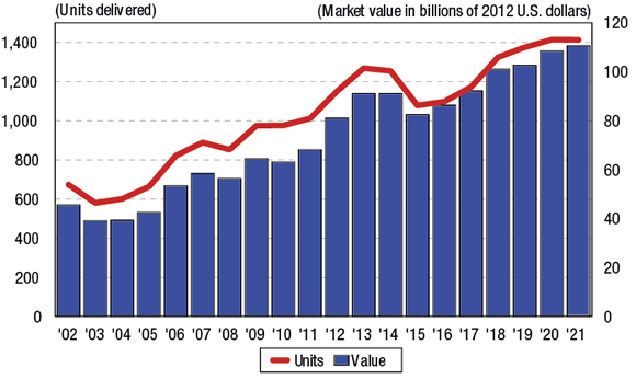

Richard L. Aboulafia, vice president, analysis for Teal Group Corp.
Courtesy of Teal Group
Commercial jetliner history and forecast.
Aviation, which is dominated by Boeing and Airbus with a combined 55 percent of the output, “powered its way through the last downturn with no cycle impact,” Aboulafia said. Worldwide deliveries of large jetliners expanded 21.7 percent from 2008 to 2011.

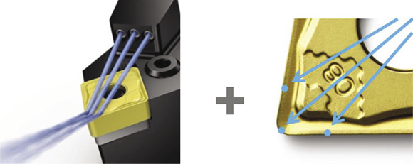

As a result, more HRSA materials are being used. A presentation at the AMT conference by Bill Tisdall, product development and turning manager for Sandvik Coromant Co., Fair Lawn, N.J., focused on how to profitably machine HRSAs.
Courtesy of Sandvik Coromant
When applying high-pressure coolant, some insert geometries direct coolant to the cutting zone.

Applying high-pressure coolant (1,000 psi and higher) is another possible route to boost productivity and tool life when cutting HRSAs. Tisdall pointed out, however, that high-pressure pumps aren’t enough and cutting tools designed to direct coolant to the tool/workpiece interface and create a coolant wedge are needed. HRSAs tend to generate stringy chips and the coolant wedge helps with chip control while reducing edge notching. In addition, inserts with geometries that help get the coolant to the cutting zone are available.
