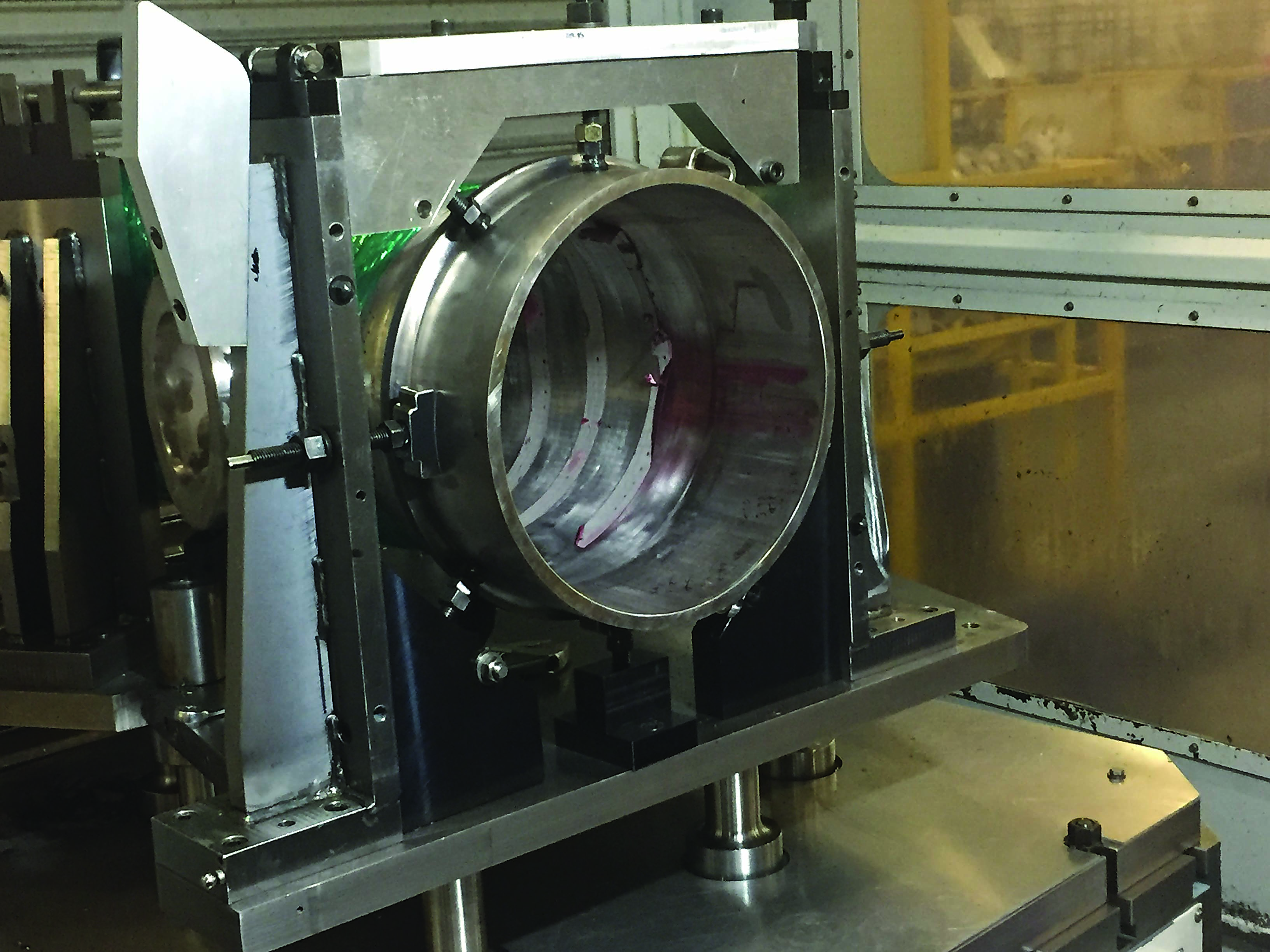

At Mitsubishi Hitachi Power Systems Americas Inc., combustion parts start as flat materials. They are then cut, formed and welded to create a final product. During the manufacturing process, we utilize lathes and horizontal boring mills to bore the geometry of critical features.
The inlet of a combustion transition piece is ready for boring in a horizontal boring mill. All images courtesy of C. Tate
In the past, as we started manufacturing parts, we struggled to machine combustion assemblies. Machining became a bottleneck process, disrupting part flow. Most of our problems resulted from boring operations.
Boring combustion baskets caused the most trouble. These long cylinders with large diameters have thin walls made from materials like Inconel, which is difficult to bore.
Our primary challenge was gaining access to the areas that needed machining. We originally used indexable boring bars with traditional steel bodies but quickly figured out they would not work because they caused chatter. We discussed several other options, including solid-carbide bars and larger-diameter specials. Eventually, we settled on mechanically dampened boring bars, which effectively eliminated chatter.
In addition, they were offered in the lengths we needed and were built to accept quick-change indexable heads. Once set in a lathe’s turret, they do not need to be removed. We simply change the head when a different-style insert is needed, which allows one bar to perform boring, grooving and threading. Flexibility reduces the overall cost of the project and shortens setup times.
Combustion transition pieces are the companion parts to combustion baskets but are considerably larger and require more machining. CTPs are not as prone to chatter because the setup is stiffer, the areas to machine are easier to reach and the walls of the part are thicker. The inlet end of a CTP resembles a large-diameter pipe. Inlet diameters are slightly different across the product line, ranging from 310mm to 320mm.

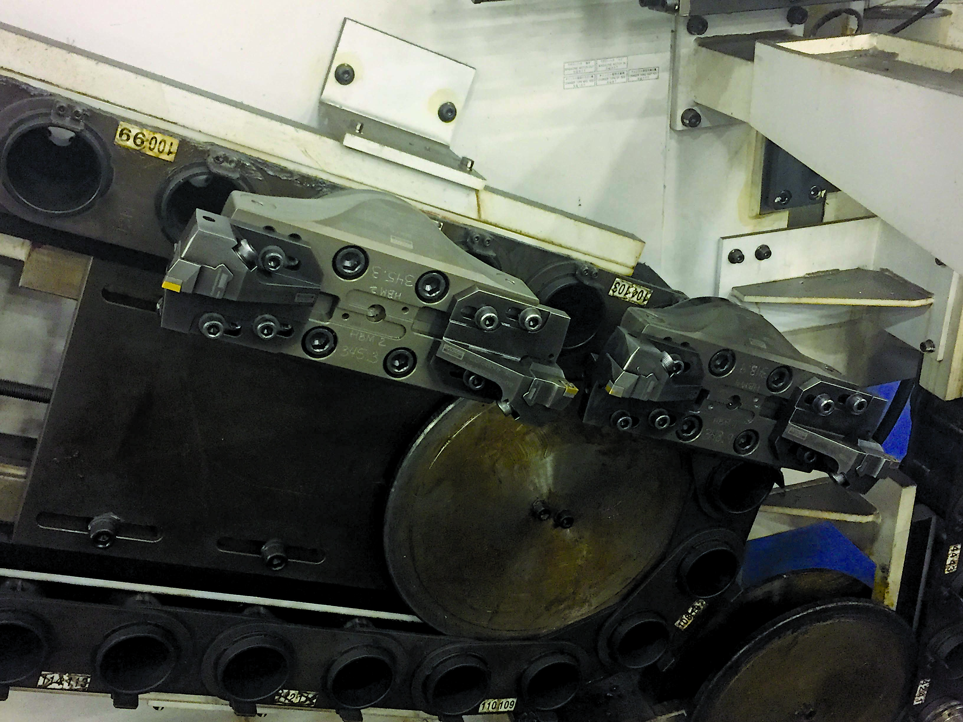

Two bridge-style boring tools in the tool chain of a horizontal boring mill. Each diameter required a dedicated tool.
Our first inlet machining operations for CTPs included helical milling. With helical milling, which was selected primarily for flexibility, we could use a single cutting tool to machine the different diameters found across the part family, thereby reducing tooling costs. Helical milling worked but was slow and plagued by premature insert failure that could break expensive milling tools. It became evident that helical milling, although effective in many other applications, was not the best choice for machining these parts.
Boring Decisions
We determined that boring would be the best option and purchased bridge-style boring tools. These tools have several advantages, starting with a Coromant Capto connection that allows us to attach various spindle adapters and extensions when needed. Bridge-style tools have a main body that will accept various subassemblies, allowing users to do ID work, OD work and face grooving. Most importantly, the costs to operate and repair the heads are far less than for the milling tools.
Modularity of these boring tools allows us to rough with simple (inexpensive) indexable holders or finish by bolting on a fine boring head that can be adjusted in 0.002mm increments. Although these bridge-style assemblies cost about $3,500 each, they are one of the best options available when boring a 320mm hole.
