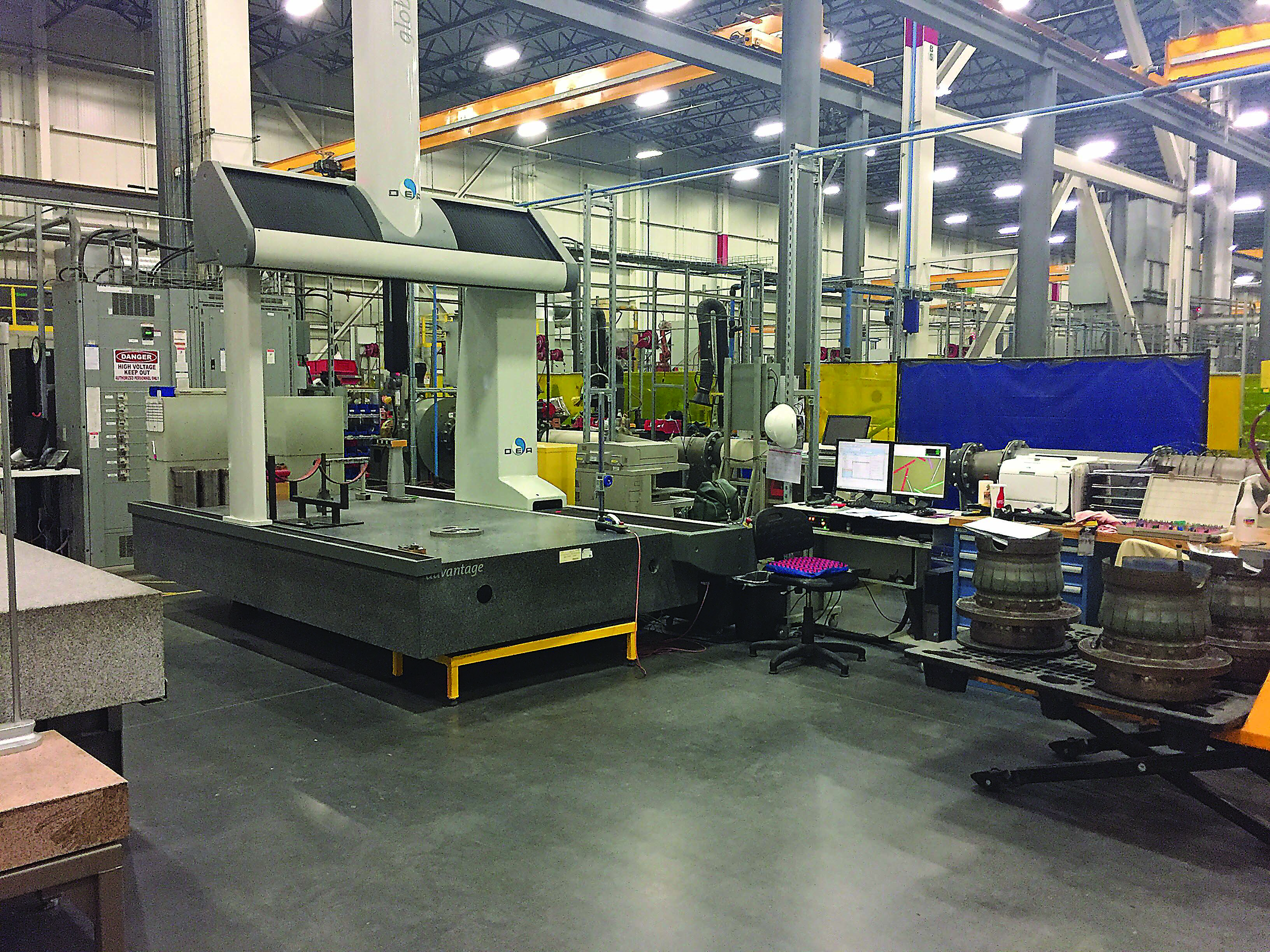

Mitsubishi Hitachi Power Systems does not house its CMMs in a laboratory or special room. This one is integral to a welding cell, and its measurements guide the assembly process. Image courtesy of C. Tate

While working at a cutting tool manufacturer, I had the opportunity to see firsthand how a floor-based CMM could drive significant improvements. The company manufactured special drills in a robotic cell where the drills were periodically inspected using a lab-based optical system. Each inspection took 45 to 60 minutes, and we routinely wasted a shift at machine changeover.
To overcome this issue, a shop-floor CMM with tactile scanning and optical inspection was purchased and positioned in the cell. Inspection time was reduced to four minutes, and data was provided in a spreadsheet that told operators exactly which offset to adjust with magnitude and direction. Changeover time was reduced to 10 minutes.
