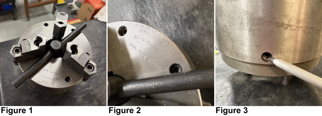

Don’t get me wrong, these four-jaw monsters have their place in the machining world, especially when holding unbalanced parts like a camshaft. As a result of the generous length of travel of each jaw, using an independent chuck makes sense when you need to turn features on a part with more than one center of rotation.
What about parts or shafts that need to both run true and have multiple features that run true to the others? You absolutely could torture yourself by spending the inhumane amount of time adjusting the part and dialing it in, all while risking the part falling out. Or you could do what we’ve done in our shop and adopt the use of three-jaw set-thru chucks. (See figures 1 and 3.) With these outfitted to most of our lathes we can firmly lock the parts in place, and use the four equally spaced impingement screws located radially on the outside diameter of the chuck.
To be fair to four-jaw chucks, the adjustment travel is much more forgiving in comparison to the set-thru type. If you’re unsure your part is unbalanced or may need a considerable range of adjustment, I would strongly suggest dusting off that four-jaw monstrosity.
