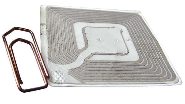

RFID tags in conjunction with smart machines allow for easier custom manufacturing. Image courtesy Wikipedia Commons.
Siemens AG developed a scenario depicting how CPS could influence manufacturing in the future. Today, a typical shampoo factory makes a batch of shampoo having a specific fragrance, then fill tens of thousands of bottles with it. Afterwards, the factory will reset the line, produce a batch of shampoo with a different fragrance and begin bottling it.
In the Siemens model, a customer would place an online order for shampoo with a specific fragrance. The order information would be saved on an RFID (radio frequency identification) chip on the bottle. As the bottle moved through the factory, the chip would interact with the smart machines controlling the fragrance and other ingredients, label and any other product-specific features for that particular shampoo. (See the whole story at tinyurl.com/siemens-shampooRFID.)
