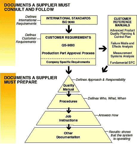

What some suppliers may find different is the level of formality and documentation QS-9000 requires, says Mahlke. Procedures and lines of responsibility that may have been informally established and explained to employees will now have to be clearly designated and the workings of the entire system will have to be written up in manuals. Documents a supplier will have to prepare include a manual that specifies who is responsible for quality and how that quality will be achieved; a manual that explains who will carry out quality procedures, what these procedures are, and when they are to be carried out; job instructions that explain how quality-assurance procedures are to be performed; and records that prove the system is working (Figure 2).
The Common Code
Figure 2: QS-9000 procedures might be viewed as a progression of documents, from those prepared for the supplier to those prepared by the supplier.
QS-9000 also stipulates that the supplier must establish and implement a product-quality-planning process, following the procedures in the “Advanced Product Quality Planning and Control Plan” reference manual that was also produced by the task force. The manual lays out a disciplined step-by-step approach to planning the quality of a product, says Dennis Whitman, GM’s manager of supplier quality. To develop a quality plan, the supplier will have to conduct feasibility reviews and a process-failure-mode-and-effects analysis and draft a control plan.
