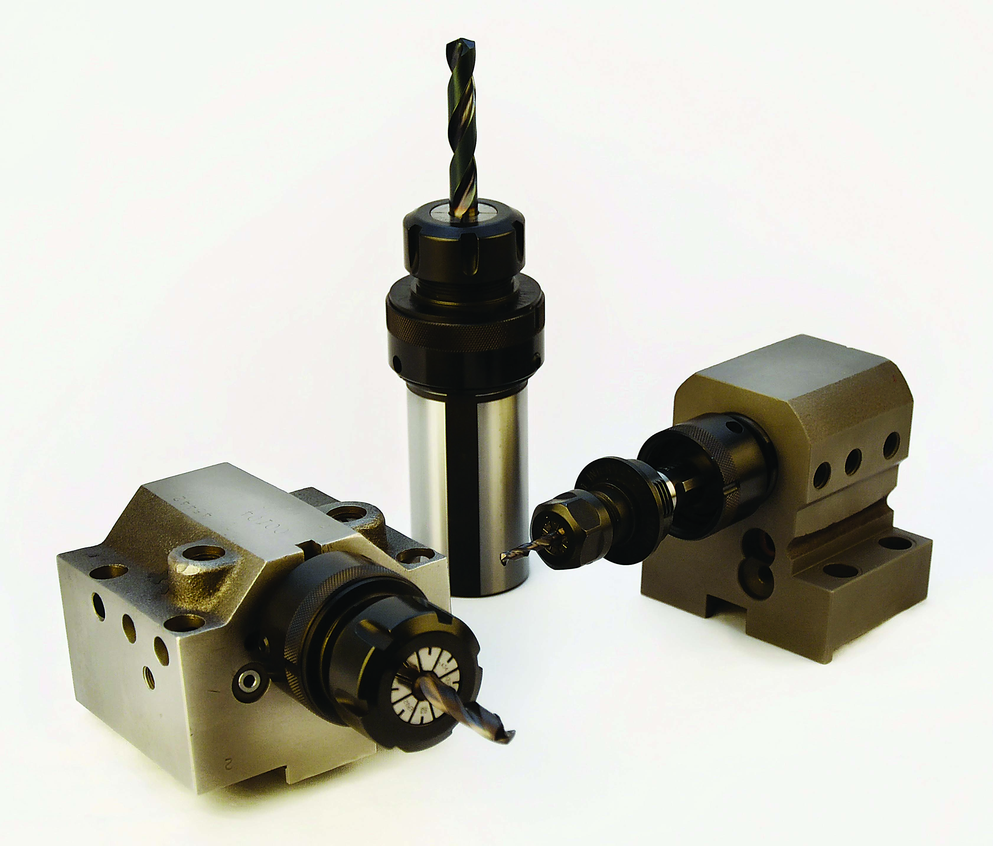

Heimatec’s HT Quick Change tooling system allows live tools and angle heads to remain permanently mounted in the machine. Image courtesy of Heimatec
Heimatec makes the HT Quick Change tooling system for use with its line of live tools and angle heads, allowing them to remain permanently mounted in the machine. A removable insert holding the cutting tool easily locks into the live tool. Inserts are available for various components, such as ER collets, side lock holders and facemill adapters.
“To change the tool, a single clamping taper screw is loosened up on the live tool cylinder guide; the insert comes out and you put a different one in,” said Hansen, who added that for a minimal cost, a machinist can have another insert sitting on the side ready to go. “When a part’s being changed, they just put in the new insert. The changeover is very quick versus taking the live tool out of the machine and having to reset everything.”

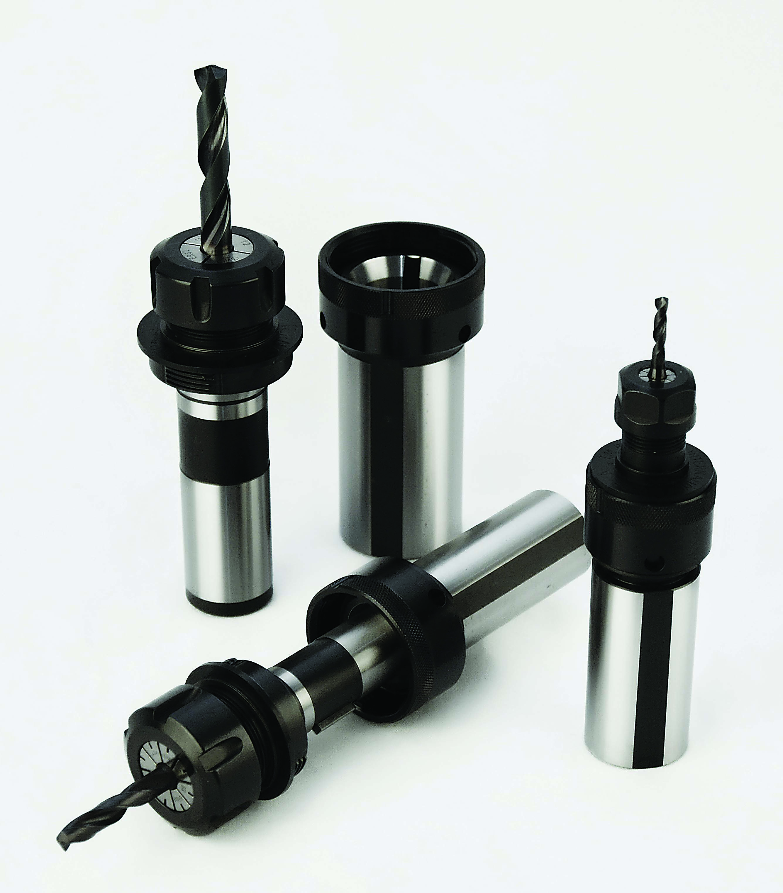

Quick-change systems from T.M. Smith Tool benefit those who make many different parts and do changeovers frequently. Images courtesy of T.M. Smith Tool International
The Smith-Lock design has OD threads on the toolholder and ID threads on the OSA, and they mate using two threaded tabs 180° apart, McKown said. “As you’re rotating the shell of the OSA one quarter turn, the OD threads and ID threads engage, which then locks the holder down.”
The T.M. Smith Ball-Lock system is also a two-piece system with ball bearings around the ID of the OSA.
“When you pull forward on the OSA shell, it releases the ball bearings, allowing them to move slightly inward, and then you’re able to insert the toolholder,” McKown said. “Once you have the holder in the adapter, you release the shell back into its resting position, which locks the balls onto the taper of the holder.”
