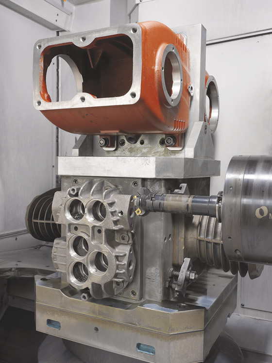

Inertia Active Control is particularly advantageous in applications that involve machining heavy workpieces with uneven weight distribution, such as this one.
One of the advantages of Makino’s DD table is that it employs inertia active control (IAC) for improved productivity. In standard rotary tables, acceleration and deceleration are typically set for maximum inertia and weight to ensure accuracy. IAC, on the other hand, uses data from the DD rotary table to evaluate inertia and provide feedback from the B-axis motor to the machining center’s control. It then adjusts acceleration and deceleration to optimal levels for the specific pallet condition.
It’s important to note that the inertia—not the pallet weight—is the problem. If the load is light, IAC speeds acceleration; if there is a heavier load, it slows acceleration. Acceleration and deceleration changes have no impact on spindle speed. Instead, the IAC improves the machining process by shortening the time to find the correct fractional angle at which to position the table.
IAC lets the indexing quickly accelerate from 0° to 90°—including the time required to unclamp the brake, make the rotation and reclamp the brake. If the machinist doesn’t program IAC, the machine defaults to a certain level. For example, if pallet weight is 100 to 200 kg, IAC adjusts the speed to midlevel, which saves 14 percent on every 90° index. If the pallet inertia is lower, the positioning time is even faster, saving 24 percent on every index. On the Makino a51nx and a61nx HMCs, IAC reduces positioning time 18 percent, on average.
This means that on a part that uses 20 tools across nine faces—or one that requires a lot of B-axis rotation—activating IAC can drop positioning time by 5 seconds, or 3.1 percent. This might not seem like much, but in a production environment, running the part on two machines for 22 hours a day at 85 percent efficiency for 250 days per year results in an increase of thousands of parts per year.
