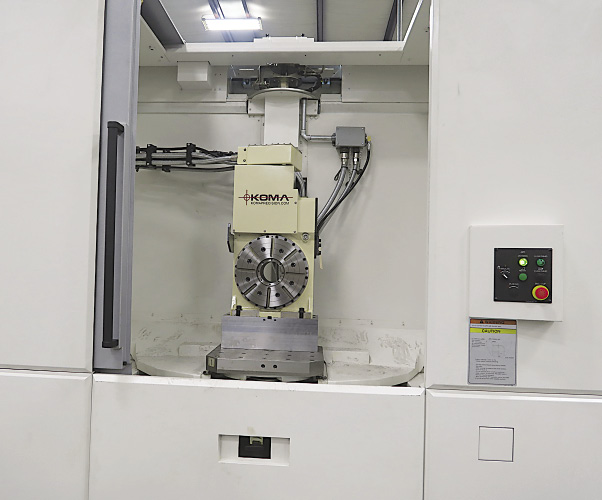

A Tsudakoma RBA-320K rotary table on an Okuma HMC at Precise Machining & Manufacturing. Images courtesy Koma Precision.

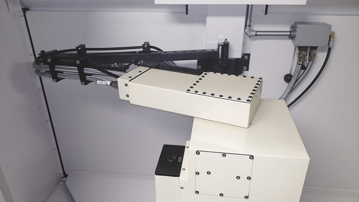

Cable management is accomplished with a scissor arm above the pallet that rotates or bends along with the movement of the B-axis on the HMC.

When Precise was looking for a 5-axis solution, it selected a Tsudakoma 12″ (304.8mm) Model RBA-320K from Koma Precision Inc., East Windsor, Conn., for its Okuma HMC. In explaining Precise’s choice, Engineering Manager Don Moody said adding a rotary table costs much less than a dedicated 5-axis machine. “It also allows us to get to the center of the part easier.”

To maintain the automatic pallet changing capabilities of the HMC, Koma’s Integration Division installed a cable management system on-site. It allows the rotary table to remain connected throughout a pallet change while keeping all the cabling out of the way of fixtures and metal chips. Furthermore, if there are hydraulics or air-sensing lines involved, this system can monitor and actuate automatic fixturing.
Cable management is accomplished with a scissor arm above the pallet that rotates or bends along with the movement of the B-axis on the HMC. On top of the rotary table, a swivel box permits the pallet to rotate ±120° in a standard configuration.
When machining high-quality aerospace parts, high rigidity and positioning repeatability are key. In this case, the Tsudakoma RBA-320K was a good fit because of its hydraulic dual-disc clamping system. This system maintains the fixture and part positioning while the machining center is taking its cuts. The machine is only as accurate as the rotary table, so positioning repeatability throughout the entire production run is critical to making good parts.
