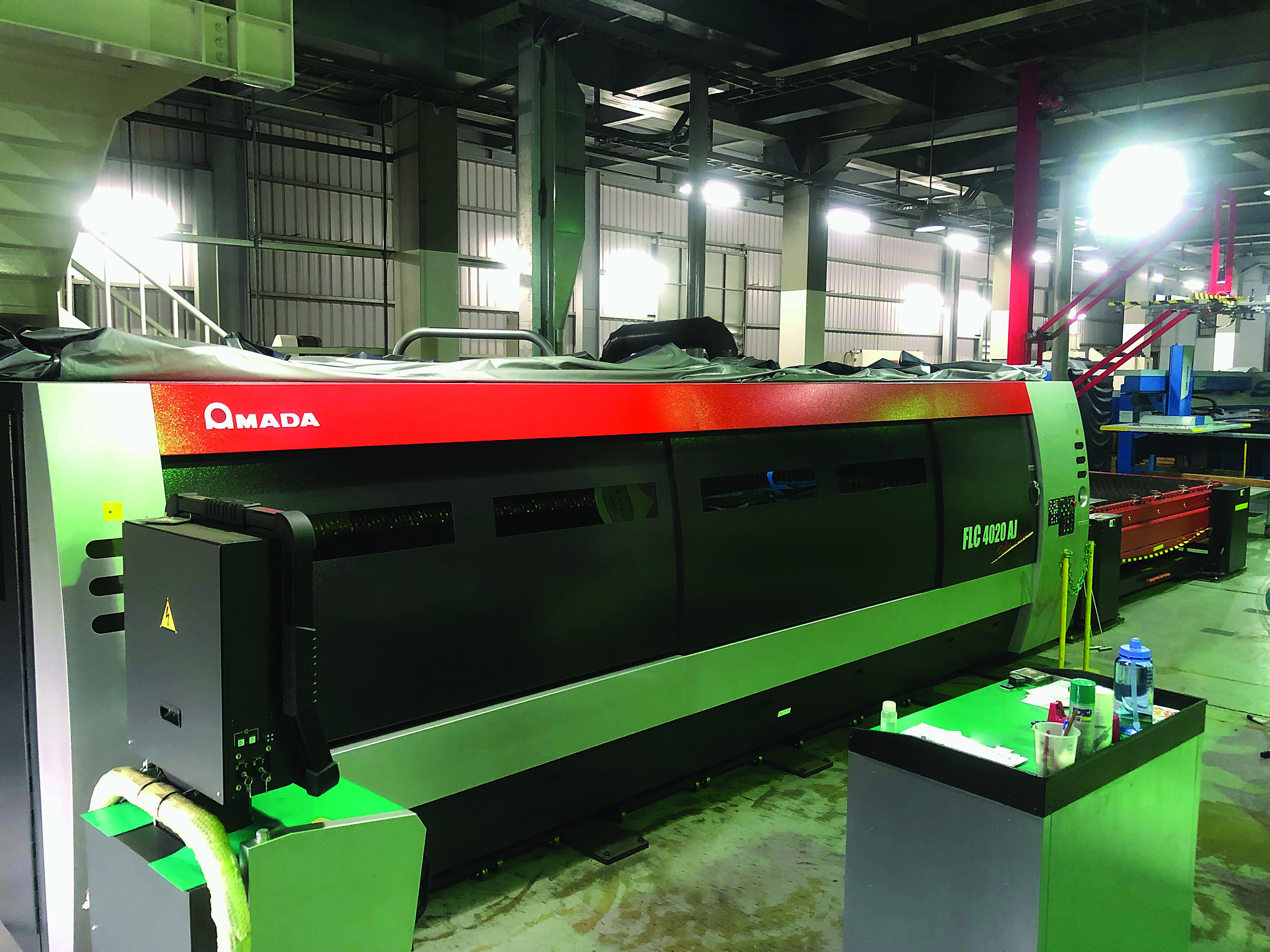

Less than a year ago, I-Cherng acquired an Amada FLC 4020AJ fiber laser, which was supplied with alternative programming software. Problems were encountered immediately with the software.
“We chose the Amada to improve our quality and productivity, having had previous positive experience with their machines,” Yo said. “However, the original software supplied with the machine did not consider the characteristics of fiber laser cutting and still appeared to use CO2 laser logic. There were many unnecessary codes in the NC programs. Also, it was not user-friendly. Staff had to spend time deleting unnecessary codes, and some programs could not cut the parts well. We could easily spend over four hours to modify the NC code in order to get it to run on the machine.”
The following month, I-Cherng contacted JetCAM to ask if a post-processor was available for the machine. The answer was yes, so the post was installed remotely and the JetCAM Expert nesting software was upgraded to version 20 across the company’s three licenses.

The Amada FLC 4020AJ fiber laser machine at I-Cherng Refrigeration Industrial. Image courtesy of JetCAM International

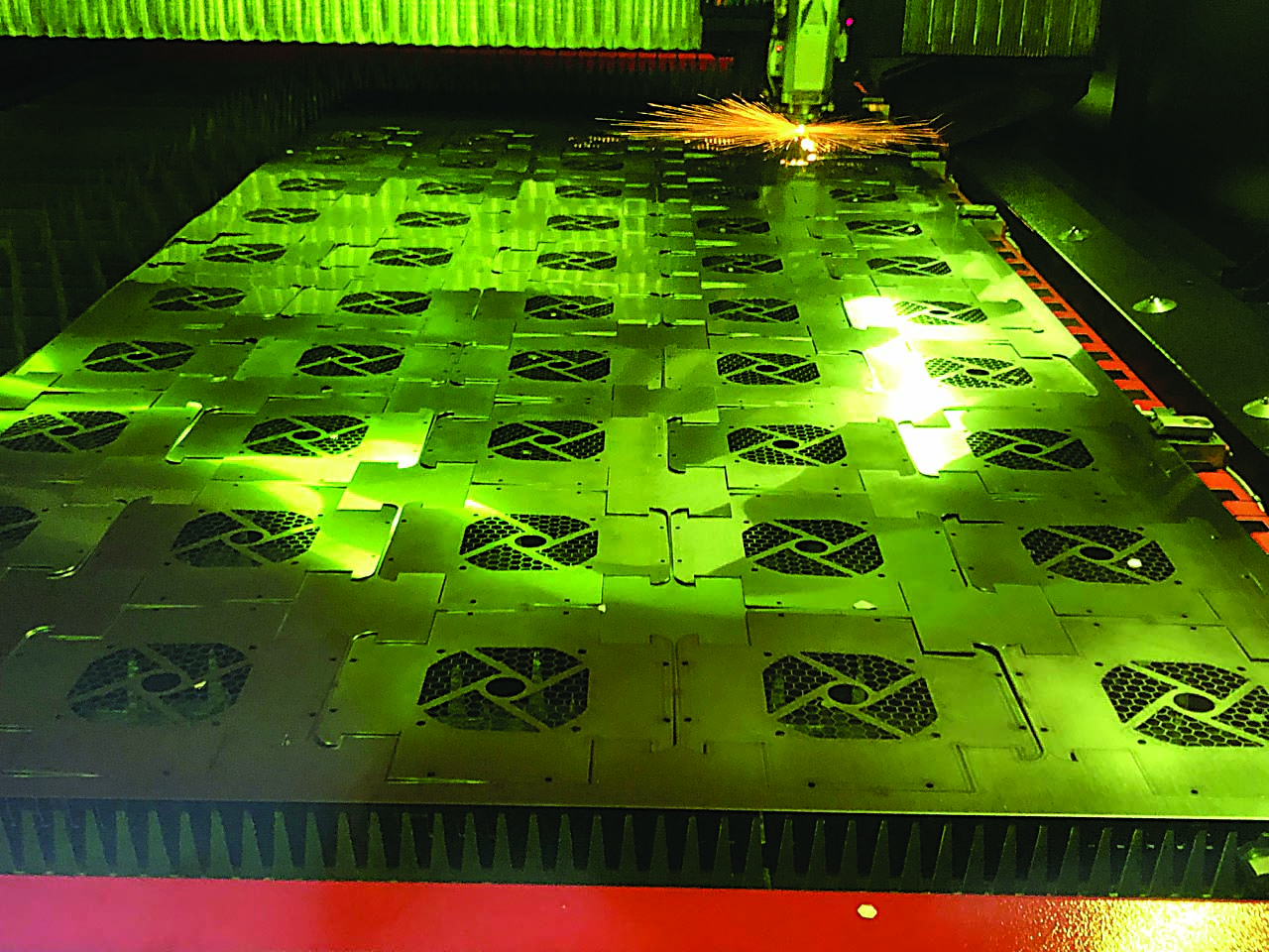

Version 20 of JetCAM Expert nesting software enabled I-Cherng Refrigeration Industrial to reduce programming time by 80 percent and machine runtime by 13.2 percent. Image courtesy of JetCAM International
Version 20 included two new features: Jet-Cut and Jet-Optimizer. Jet-Cut provides automatic fly cutting, or grid cutting, based on predetermined parameters. This feature locates grids of internal holes and then splits the cutting into separate, short line segments that lie on the same line or circle. The cutting head is kept down when moving, and the laser beam is switched on and off on the fly, which dramatically reduces the cutting time of grids. Rounded movement between cuts can be applied as the laser head moves to the next row, minimizing acceleration changes. Once configured, the entire process is automatic and applied with a couple of mouse clicks.
Jet-Optimizer optimizes the sequence of cutting internal holes to minimize machine movements while also avoiding travel over previously cut areas and reducing the risk of collision.
Compared with the same nests generated by the originally supplied software, machine runtime was reduced by 13.2 percent using Jet-Cut.
