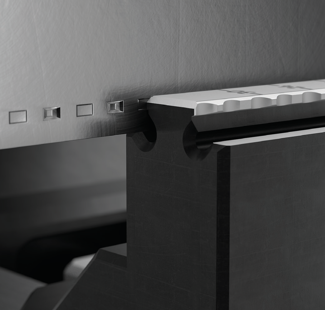

As 5-axis machining grows in popularity, the need for high-profile yet rigid vises able to lift workpieces into the work area is abundantly clear. Most of the available options require that part blanks be pre-machined with a dovetail shape along their bottom edge, which allows the workpiece to be gripped using a small amount of sacrificial material that is later removed.
Eric Nekich, operations, technology and inside sales manager at Hartland, Wisconsin-based Lang Technovation Co., suggested there’s a better way.
“Most people don’t stop to evaluate the cost of pre-machining both in time and lost material,” he said. “For instance, a dovetail cutting operation might take 20 minutes and use 1⁄4″ of material whereas our Makro-Grip stamping unit takes maybe five seconds of workpiece prep and only uses 3mm of material.”
The Makro-Grip stamping unit produces dimples on the workpiece. Photo credit: Lang Technovation
The Makro-Grip stamping unit produces dimples on the workpiece, which connect with mating bumps in the Makro-Grip vise jaws. Image courtesy of Lang Technovation
The tool clamps a workpiece blank in a special fixture, which creates a series of small dimples where the dovetail would normally sit. These dimples connect with mating bumps in the Makro-Grip vise jaws. Investment in equipment is needed, but Nekich said return on investment is usually fast. He also said the product is not a be-all and end-all solution. Depending on part geometry, a dovetail might be a better option.
“I’m probably a little biased, but if the name of this company was Eric’s Precision, I would go for the Makro-Grip all day long just because of the time and energy it saves,” he said. “I don’t need a milling machine and special cutters, the parts can be pre-stamped in the toolcrib or warehouse, and it’s easy enough that anyone can do it with a few minutes of training. It’s a very simple process, and for those operations where it works, it works really well.” —K. Hanson
